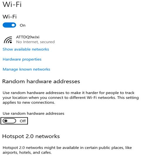

PSPICE for TI Licensing error
I installed PSPICE for TI this morning at the office, but this afternoon I am getting a License error and cannot complete or save my small design.  Can I use the same installation on the same laptop at home and at work (with different IP addresses) or is the free license restricted to using only one IP address even if running on the same laptop?
How do I synchronize so that there is no more error.  I

  • Walter,
    Apologies for the follow-on question, but could you please attach the log file to this thread if it is available?
    It will hopefully be at %APPDATA%\Roaming\Cadence\PSpiceTIInstall\cdsPspiceTIlog.txt

    8:42:24 PM Monday, August 3, 2020 : error_code cdsVblRegisterInstallation: -8
    8:42:24 PM Monday, August 3, 2020 : strErrorMsgDesc: Access key entered is not in expected format. Please go to http://e2e.ti.com for further assistance.
    8:43:31 PM Monday, August 3, 2020 : error_code cdsVblRegisterInstallation: -8
    8:43:31 PM Monday, August 3, 2020 : strErrorMsgDesc: Access key entered is not in expected format. Please go to http://e2e.ti.com for further assistance.
    8:43:34 PM Monday, August 3, 2020 : error_code cdsVblRegisterInstallation: -8
    8:43:34 PM Monday, August 3, 2020 : strErrorMsgDesc: Access key entered is not in expected format. Please go to http://e2e.ti.com for further assistance.
    8:43:46 PM Monday, August 3, 2020 : error_code cdsVblRegisterInstallation: -8
    8:43:46 PM Monday, August 3, 2020 : strErrorMsgDesc: Access key entered is not in expected format. Please go to http://e2e.ti.com for further assistance.
    8:43:49 PM Monday, August 3, 2020 : error_code cdsVblRegisterInstallation: -8
    8:43:49 PM Monday, August 3, 2020 : strErrorMsgDesc: Access key entered is not in expected format. Please go to http://e2e.ti.com for further assistance.

    10:16:53 AM Tuesday, August 4, 2020 : error_code cdsVblRegisterInstallation: VblSuccess
    10:16:53 AM Tuesday, August 4, 2020 : error_code cdsVblRequestLicense: VblSuccess

    This problem may occur if user has turned on “Use Random Hardware address”  accessible from the settings tab, Network and Internet > Wi-Fi > Random Hardware Access  as shown below:
    If Yes, turn off the Random Hardware address. Wi-Fi mac address adapter Address is used as the primary source to register the user and subsequently it is used to track the user license validity. If the user has installed the product while he had turned on Random Hardware address, he had to turn it off and then
    reinstall again as his registration went with a Random Primary Mac.
     If you can, please give these steps a try and let me know how it goes.
