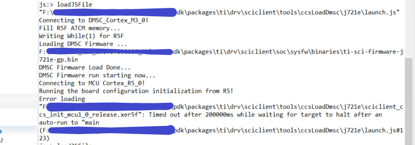

I have a XDS110 and a hardware based on dra829,however the JTAG interface on the hardware is not the same with the XDS110 (see picture).please help me how to connecte my XDS110 with my hardware!

If I understand the log file correctly - it appears you able to connect to the DMSC (which confirms the JTAG connections), but failed when attempting to connect to the MCU. Is that correct? Have you setup CCS correctly?
Yes,you understand correctly ,it failes when connect to MCU.CCS was set up corectly,because i can debug on EVM_J721E.Is there any other errors which may cause this faults?
Your error message says attempt to run board initialization script, but then says error loading. Do you have a path/setup issue to the GEL files?
