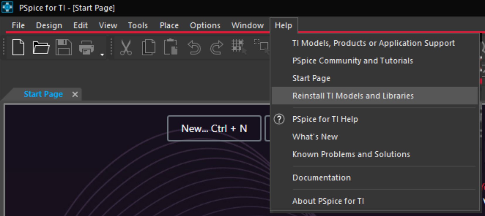

    Please try rebuilding the library by using Help/Reinstall Models and Libraries:
    After that, please restart the tool, do not accept any offered updates for now, and try running your simulation.
    Please let us know if that fixes the problem. Thank you for your patience.

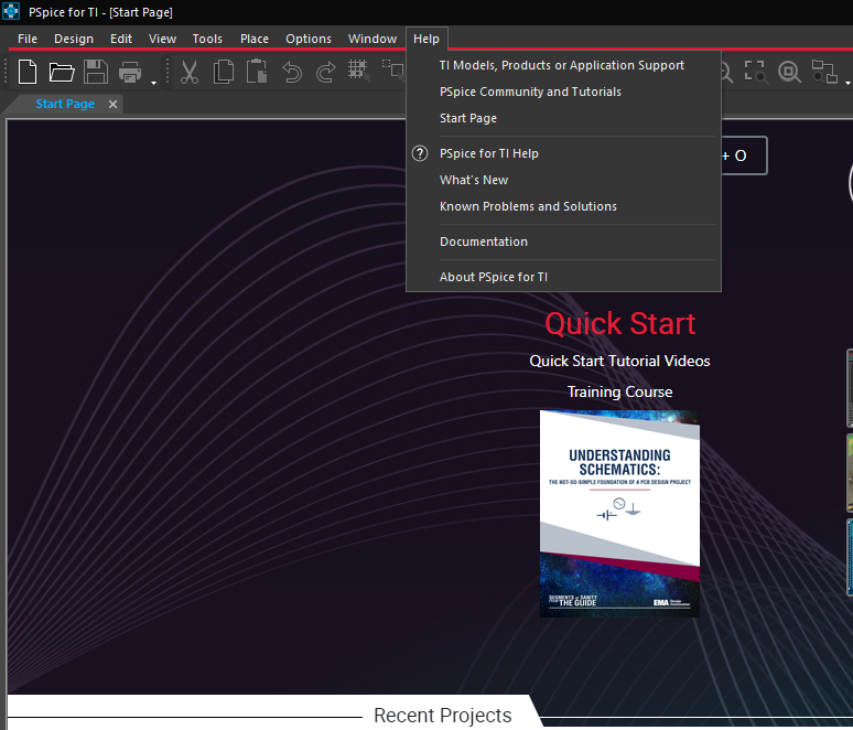

  • Hi John,
    Thanks for prompt reply. However, on my installation under "Help" you do not get the "Reinstall TI Models and Libraries" option, see below
    Robert
  • Hi John,
    Doesn't look like the screen shot stayed after posting so here goes again :-
  • Thanks Robert.
    I forgot I am working with a beta version. Sorry about that.

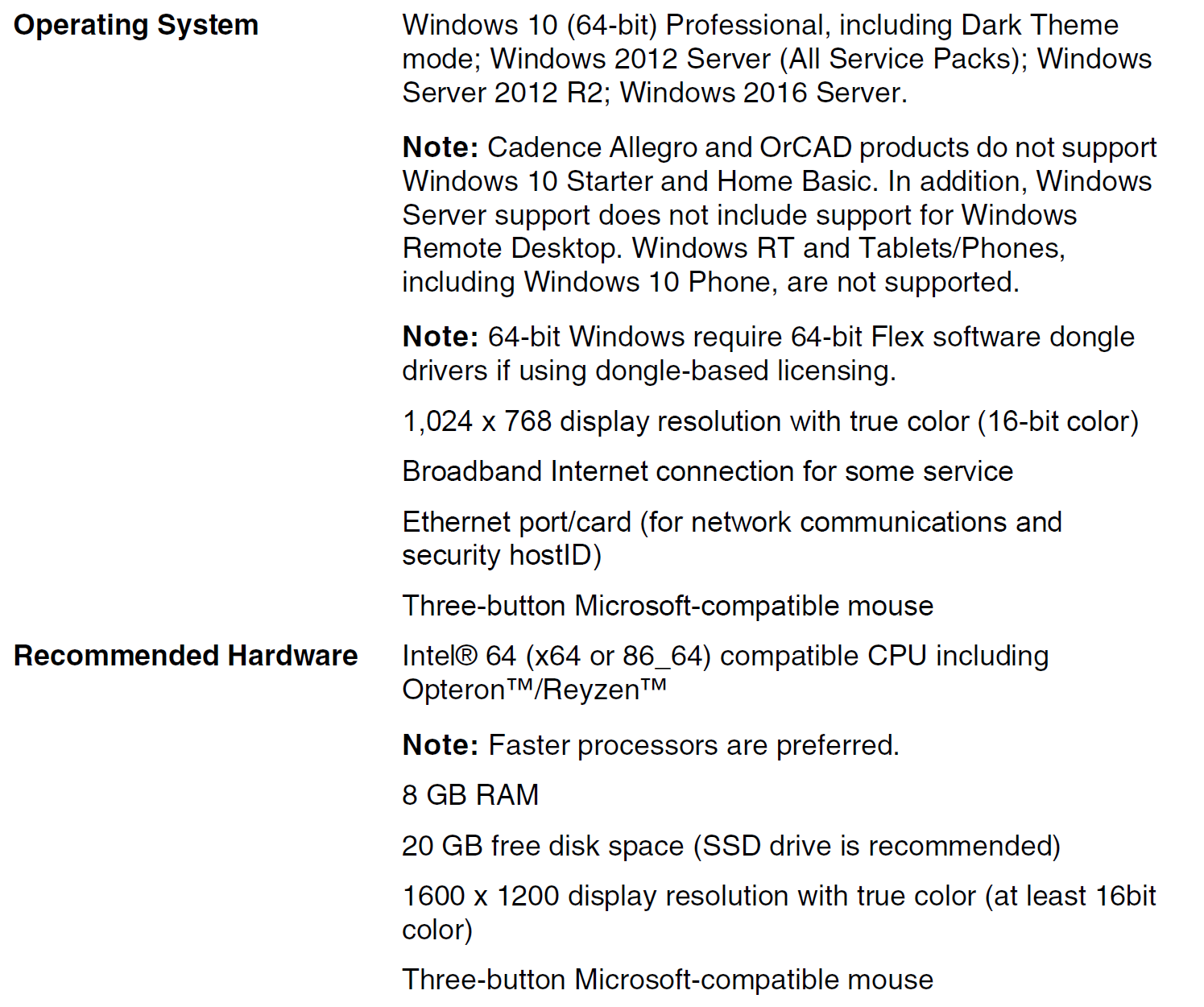

    The minimum system requirements specified by the Pspice for TI vendor are shown below.
    Does it align with the machine you are using?
    John

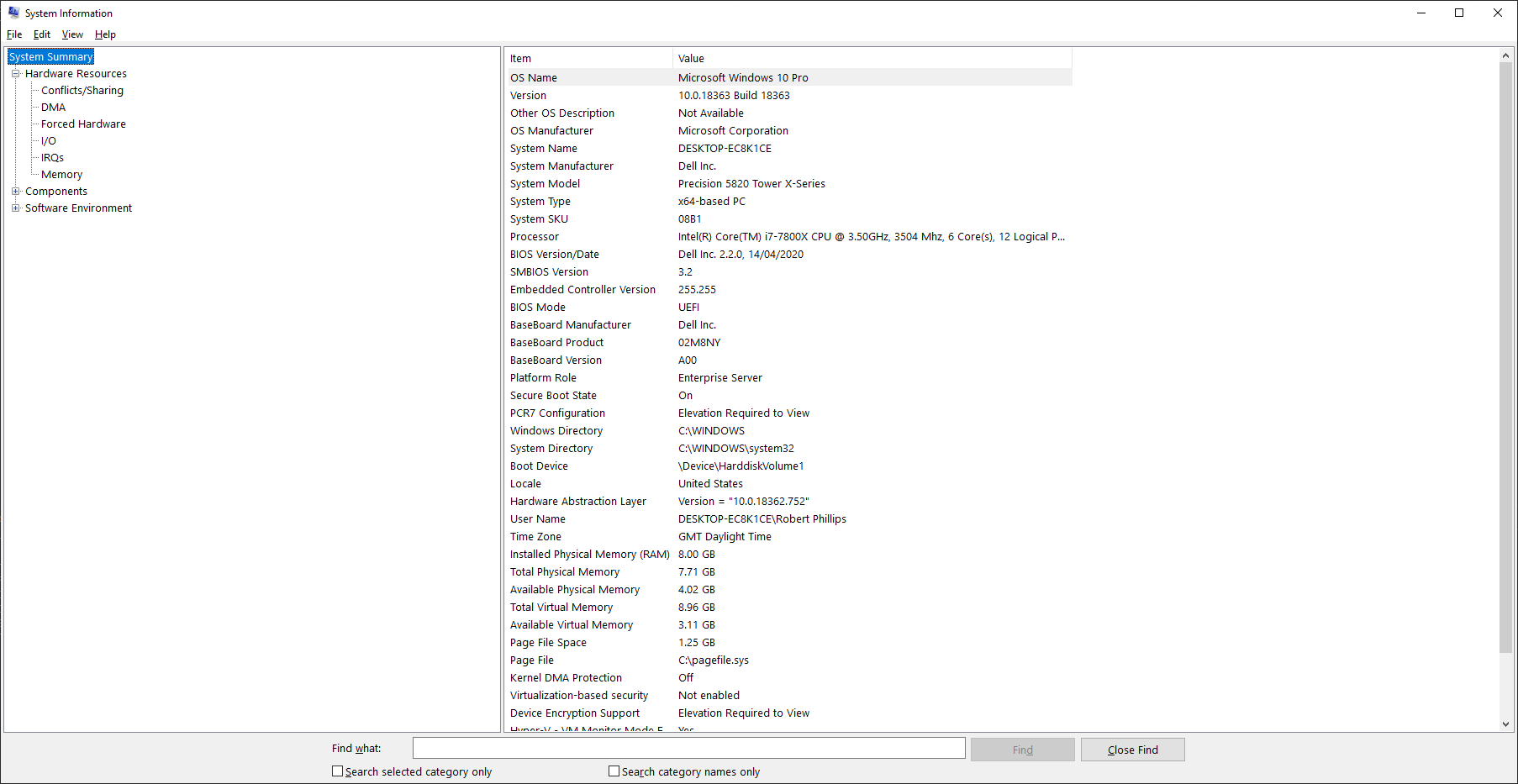

    As for the platform, it is a fairly high end Dell tower running 64 bit Windows 10 Pro  so I think it should be OK. Here is a screenshot of the system resources reported by PSpice Help.
    Robert
