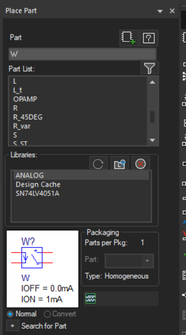

1) How do I update a common default library with a list of the components I want to always have available to any of my projects?
2) What's the shortcut method to importing a set of {lib,olb} files that I can download and unzip individually into the PSpice_TI so that they are as integrated as the pre-loaded components for my setup?
    You will need to manage that yourself. As mentioned, LIB and OLB can be anywhere.
    What you really "importing" is a SUBCKT (which you start by specifying the LIB file it is in) and what you get is an OLB file that contain a symbol that will call for that SUBCKT. You still need to reference the LIB file at simulation run time (the model definition is not "imported"). There isn't a way to insert symbols to the categories. TI is managing that hierarchy (which mirrors the ti.com product hierarchy) so users don't have to.
    This is where you completely missed the mark. I know I can put those files into any folder I want. I know that I can link/reference/load/import (whatever the menu says) valid files from that or any other folder so that I have a part to work with (a symbol,  a set of termination points, and an electrical behavoir routine to use to analyze a circuit containing this thing).   However, that is just one additional part for that one project or schematic.
    That is a pain in the A**.
    Just like in programming, I would like to assemble a set of my own routines and tell my compiler that every time I start this compiler to include a reference to those routines. In this case PSpice is compiling the code defined by the schematic and its routines are the individual parts. Just like in programming, the language comes with a set of "default" libraries and functions I can use. PSpice has its native generic parts and an extra library of parts from TI.  These are identified and displayed each time the program starts up. These lists are essentially "permanent" within PSpice.
    I am asking for a description of what I need to do so that I can assemble a tool chest of my own components (parts) that sit in a list that is always available to any project I may start WITHOUT the need to individually change each project to include this list as a reference. This custom list that I build would be as "default" as the parts already in the system.  If my list is listed in the parts picker, too, that would be a bonus. If I can make a hierarchical list (like that of the parts locator) even better.
    How do I get PSpice for TI to add my custom list to the installed lists each time it starts up?

    When it comes to having your own library, there are 2 things to consider. First, making symbols available to your schematic. Click "Place", "Part". This will bring up a panel in which you can browse and add symbol library (OLB files):
    You can copy the symbols of components you use frequently into a single OLB file.
    The second thing is the model (LIB file). This is specified in the simulation profile. You may have a number of LIB files for models you use often. Usually you add only what you are using for a particular schematic in the simulation profile. Nevertheless, you can create a single .LIB file and include that in every simulation profile if you want. This master LIB file just contains pointers to the individual LIB files in your collection. An example is C:\Cadence\PSpiceTI\tools\pspice\library\nom.lib.
    I need to check if there is a way to automatically include your customized OLB and LIB file at start up.

    When it comes to having your own library, there are 2 things to consider. First, making symbols available to your schematic. Click "Place", "Part". This will bring up a panel in which you can browse and add symbol library (OLB files): ...snip ...
    Is the "nom" name a suggestion (convention) or must this "library of libraries" file that I would build have that name in whichever path I decide it should live?
