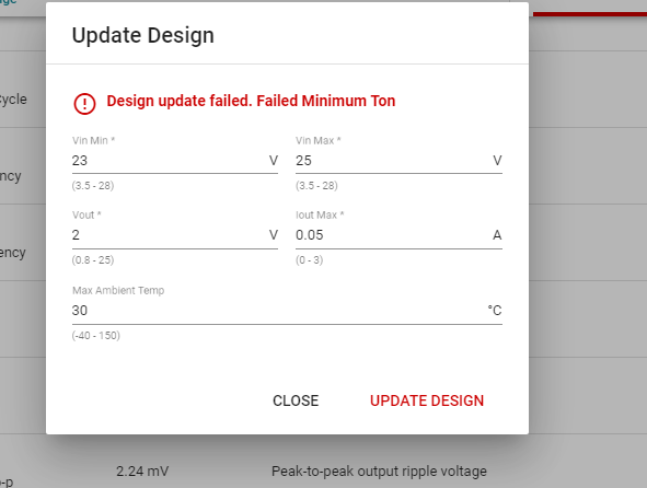

Hello team,
Customer tried to simulate with the below condition but the error was occurred.
In their understanding, the below conditions would be ok on the datasheet.
Vin : 23V - 25V
Vout : 2V
Iout : 0.05A
Is The error seen due to limitation of WEBENCH ?
Thank you and best regards,
Michiaki
  • Hi Michiaki-san,
    Please note that for the above condition the device is violating minimum ton condition.
    Please find the calculation below.
    minton of the device = 130e-9
    Dutycycle_min= 0.036
    fsw = 570e3
    Dutycycle_min/fsw = 63e-9 which is less than minimum ton.
    Let me know if you need anything.
    Thanks and Regards,
    Atul
