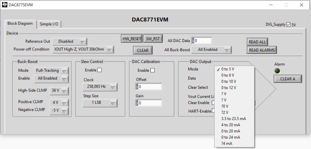

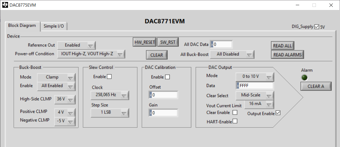

Follow the datasheet, I already got positive 0V-10V on VOUT and use the below configuration:
DAC8771EVM software:
(And I have got negative 15.36V on VNEG and positive 15.36V on VPOS on DAC8771EVM board)
But when I want to get negative 0V-10V on VOUT, try to change some options like "Clear Select", "Buck-Boost:Mode", "All Buck-Bost", finally still get positive 0V-10V,
What should I adjust on software to get negative 0V-10V?
