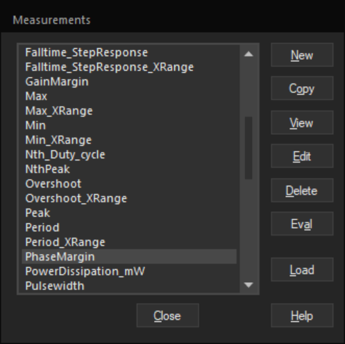

    For your second question, it appears that you were looking for a measurement. In the results window, click "Trace" -> "Measurements", then look for PhaseMargin and GainMargin:
