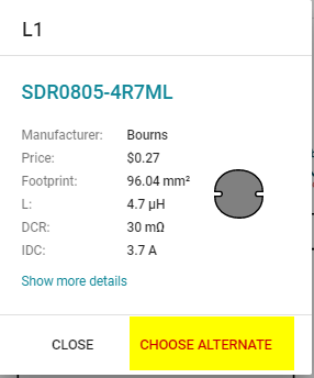

    3. After narrowing down the search you can open designs from possible solutions. Here you can customize BOM components as required (select from alternate BOM). E.g. I clicked on inductor from one of the design. It has option to choose from alternate parts. Here you can choose from required inductor (For capacitors follow the same).
