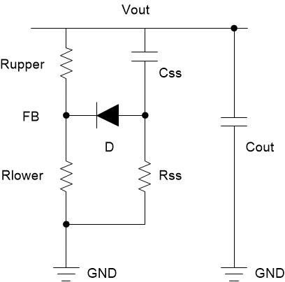

    Can you tell me what would be the inrush current based on current design?
    If the inrush current is above 1A what value of output capacitor should I use to get a inrush current upto 1A?
  • Hi Sahol,
    Sorry I didn't understand the question. Why are you worried about the inrush current? Do you hope to get a lower inrush current less than 1A?
  • My application is battery powered. The input to the boost is provided by the battery. At power up due to inrush current and battery esr the input voltage can be dropped significantly. This can cause the boost to reset. That's why I wanted to know what would be the inrush current based on design. If it's way high like 1.5A - 2A then it needs to be reduced to 1A by changing the output cap value.
  • Hi Sahol,
    There is LM2735 Pspice model on ti.com for simulation. You can use the model to simulate the inrush current.
    If the inrush current is still too high, an external soft-start circuit shown as below can be added to reduce the inrush current. You can use 22nF for Css and 10kohm for Rss.
