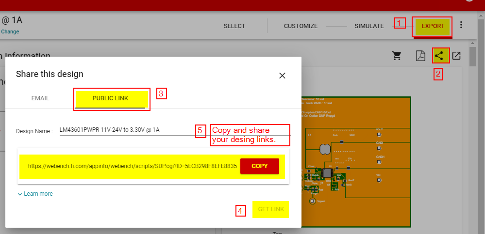

I am curious about this key. I assume I could use this key to refer to the simulation and be able to retrieve the simulation later? Maybe it is even possible to email the key to a colleague? Will he then be able to open my desgin?
What is this key for? How can I use it?

    On sharing your designs with your colleague, its very easy in Webench. Follow below steps and share the design links with your colleagues(one example below with public link). And they will be able to open your shared designs.
    Another way to open your older designs is go to MyDesing section of Webench. Hope this helps. Let us know if you have any further query about the tool.

    There is no significance of the master key value shared in the PDF report. Getting back to your past simulations and sharing of the designs can be done from within the tool as outlined above. Master key string in the PDF report is only used for internal TI purposes. Hope this helps.
