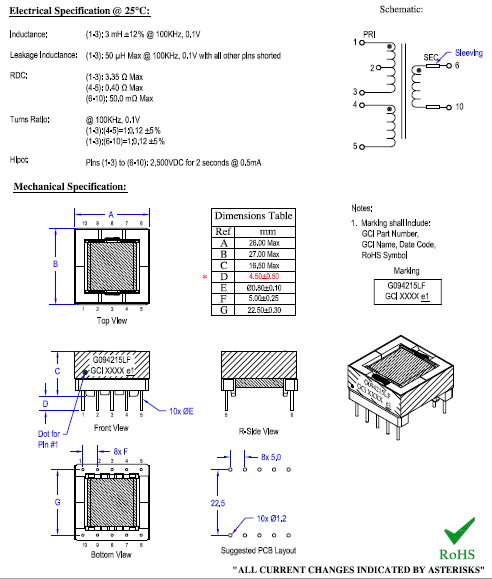

Now here, I made the circuit as per the PMP7760 with the GCI G094215LF and powered up with 200VDC but output is not coming out. I guess transformer is not switching at all.

I am attaching you our inhouse developed schematics , and transformer detail with gerber view for your reference.

    Your transformer primary winding polarity appears to be wrongly used. Please cross check PMP7760 transformer connections.  Pin 1 should be connected to the MOSFET drain and Pin 3 to the input rail.  Could you exchange pin 1 and pin 3 connection on your circuit?
