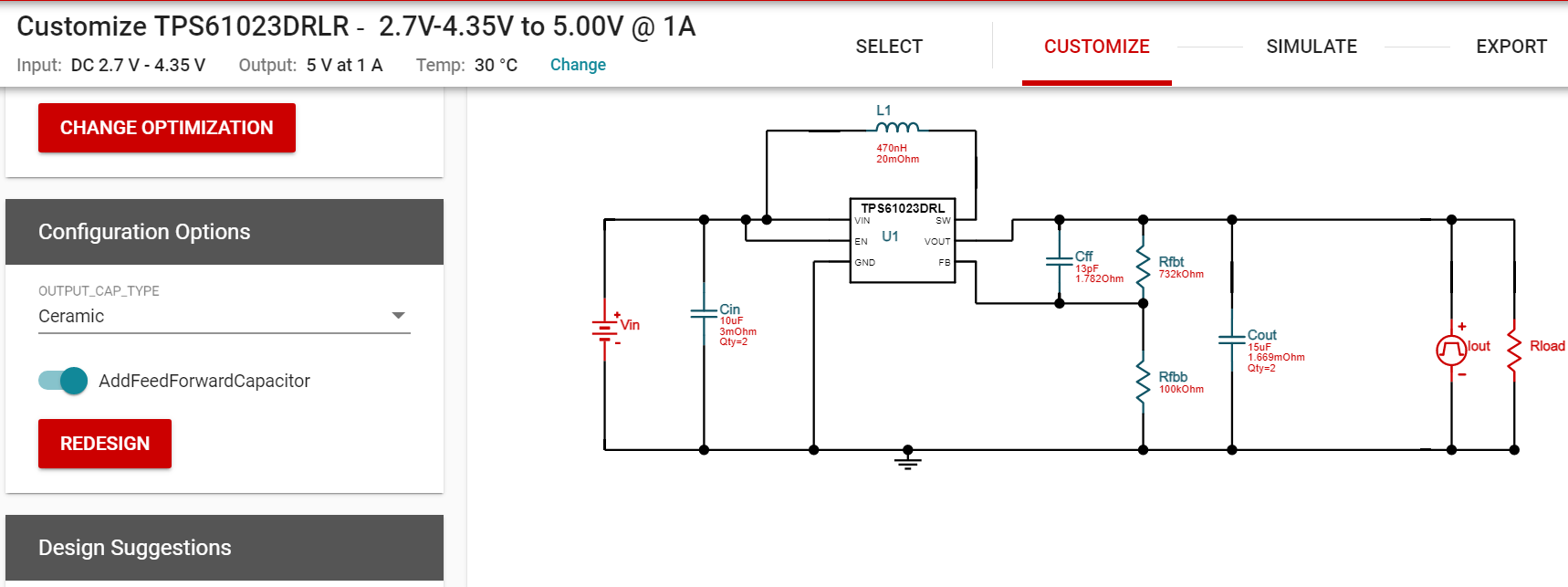

When I add a feed forward cap to the design it set it at 1pf, If I change this to other values, like 100-200pf, WebBench stop working and give no results when I ask for a re-calculation
Is there a max range for the feed-forward cap??

  • Hi Tom,
    In device TPS61023 ,for default condition we are able to set a value up to 13pF for Cff capacitor as shown in image below.
    As we increase Cff capacitor value from 1pF to 13pF,phase margin keeps increasing from 68.85  to 118.54 degrees.
    As per Webench standards, recommended phase margin range is from 35 to 120 degrees, we fail the designs that generate phase margin outside the range.
    For device TPS61023,for default condition any value of Cff capacitor greater than 13pF increases phase margin beyond 120 degrees,
    hence fails to create design.
