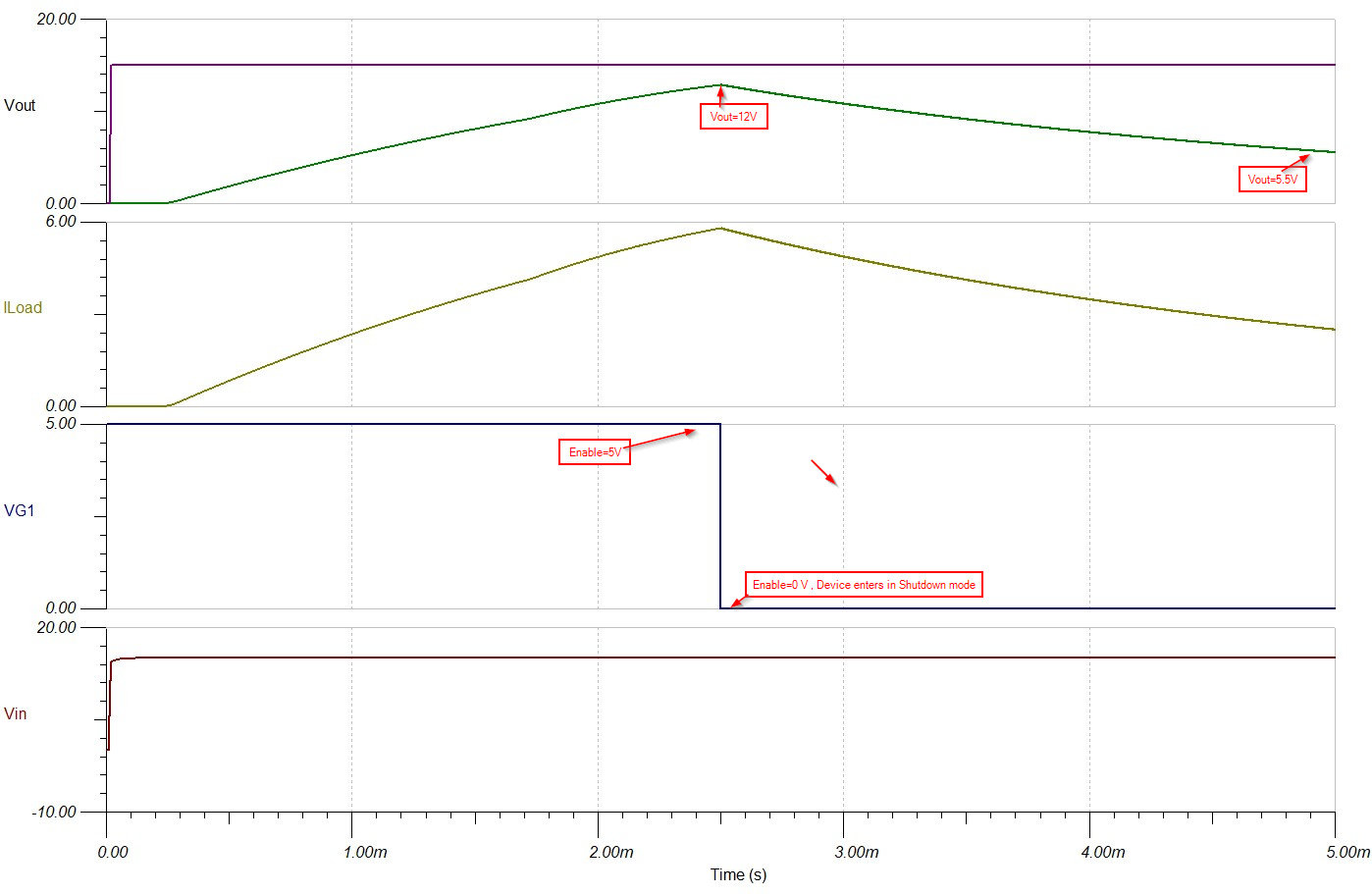

  • Hi Anna,
    Seems like you are trying to measure the time duration between when the device enters into shutdown mode and output voltage drops below 5.5V. This can be achieved as follows.
    LM5176-Q1 enters into shutdown mode when EN/UVLO voltage is less than 0.7V. The device doesn't switch and output voltage falls down gradually from the steady-state value to zero voltage. This duration is dependent on the RC time constant. (Output capacitor and load resistor)
    We have set the output power to 65W (Vout=12V, Iout=5.41A , RLoad= 12V/5.41A=2.21 ohm).
    The input to EN/UVLO pin is a pulse voltage source (5V for t=0-2.5ms and 0V for t>2.5ms).
    Please find the attached .tsc file:
    ./cfs-file/__key/communityserver-discussions-components-files/234/LM5175_2D00_Q1.TSC
    Result:

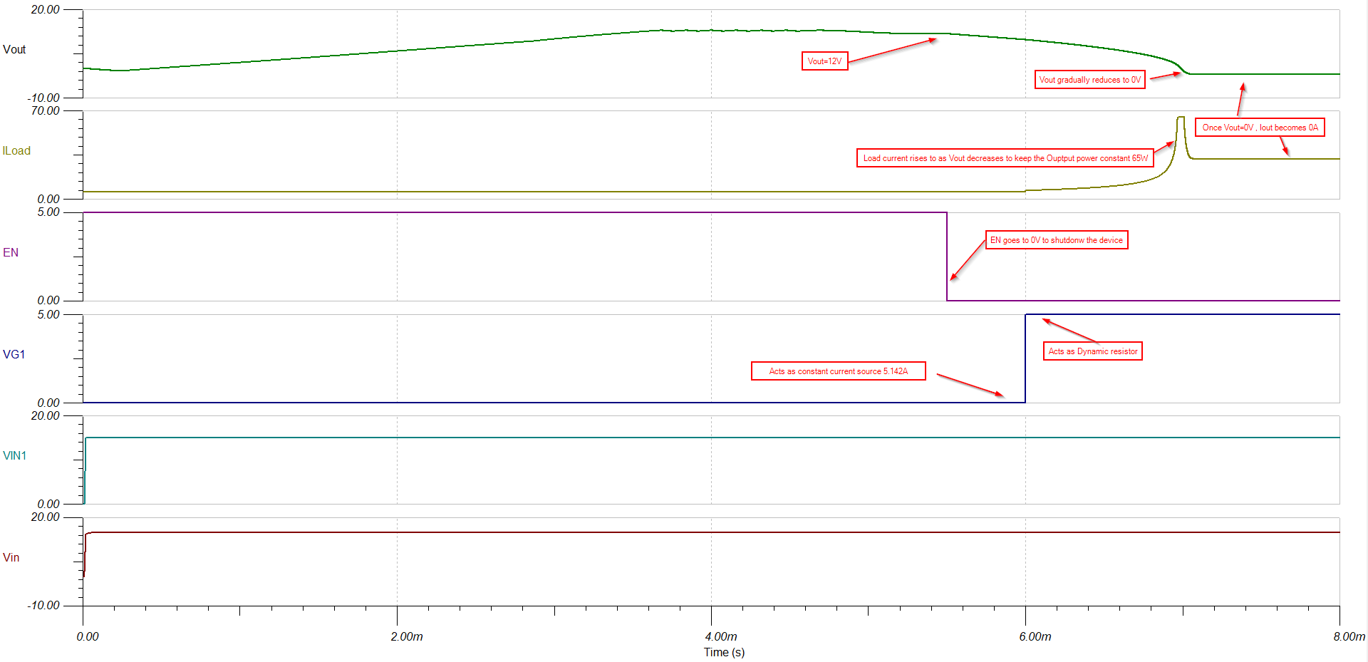

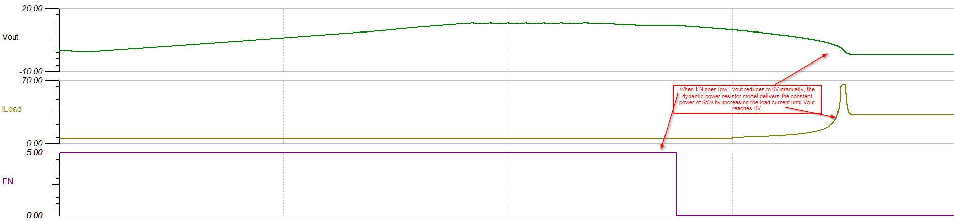

  • Hi Anna,
    We have implemented the power resistor model as per your requirement. Please find the attached LM5175-Q1 TINA model below.
    /cfs-file/__key/communityserver-discussions-components-files/234/7220.LM5175_2D00_Q1.TSC
    Result:
    Please note the below points:
    1. VG1 voltage source goes high at 6ms until this time Vout settles to 12V steady-state value with a load current of 5.142A to deliver 65W power.
    2. Voltage control voltage source along with ABM acts as Dynamic resistor when VG1 goes high(5V) and it acts like constant load current source of 5.142A when VG1 is low(0V)
    3. When EN goes low, the device enters into shutdown mode and Vout reduces to 0V gradually, the dynamic power resistor model delivers the constant power of 65W by increasing the load current until Vout reaches 0V.
    Hope this will satisfy your requirement. Kindly use the same power resistor model for LM5176-Q1. Please let us know if you have any queries.
    We would like to know the application where this power resistor will be used? Could you please provide a brief explanation?
    Thanks & Regards,
    Praveen

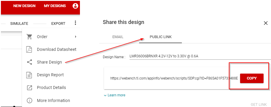

  • Hi Anna,
    Could you please share the WEBENCH design for the TINA exported file using the 'Share Design' option?
    Thanks & Regards,
    Praveen

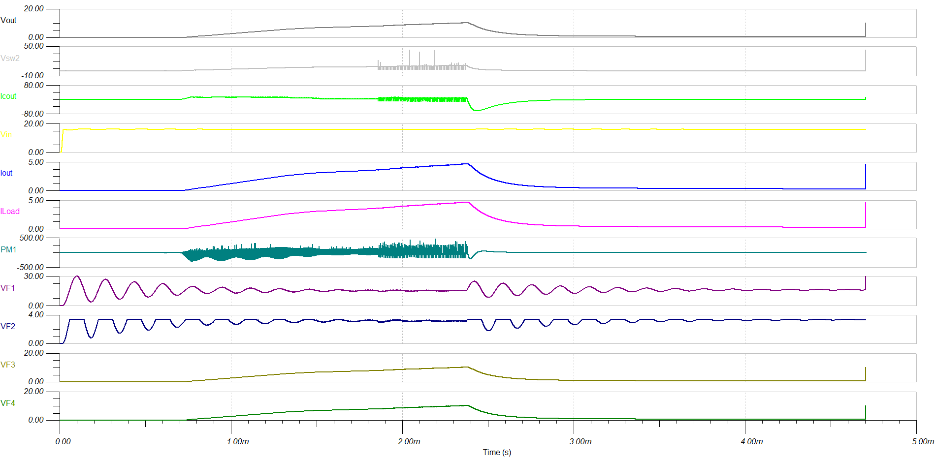

  • webench_design_good_v.tscHi Praveen,
    The simulation provides me some unrealistic results for the power consumption of the FETs and the inductor (Tina simulation file attached).
    I did a transient simulation for 35 msec. Can you indicate why the power consumption results are that large?
