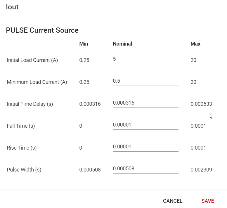

    The load transient specification can be changed as follows.
    1. Go to SIMULATE tab.
    2. Click on Load transient test bench
    3. Click on Load current source
    4. Click on update
    5. Provide the specifications as per your requirement.(Modify the Rise/Fall time to get required value of slew rate)
    6.Click on SAVE  and run the simulation.
