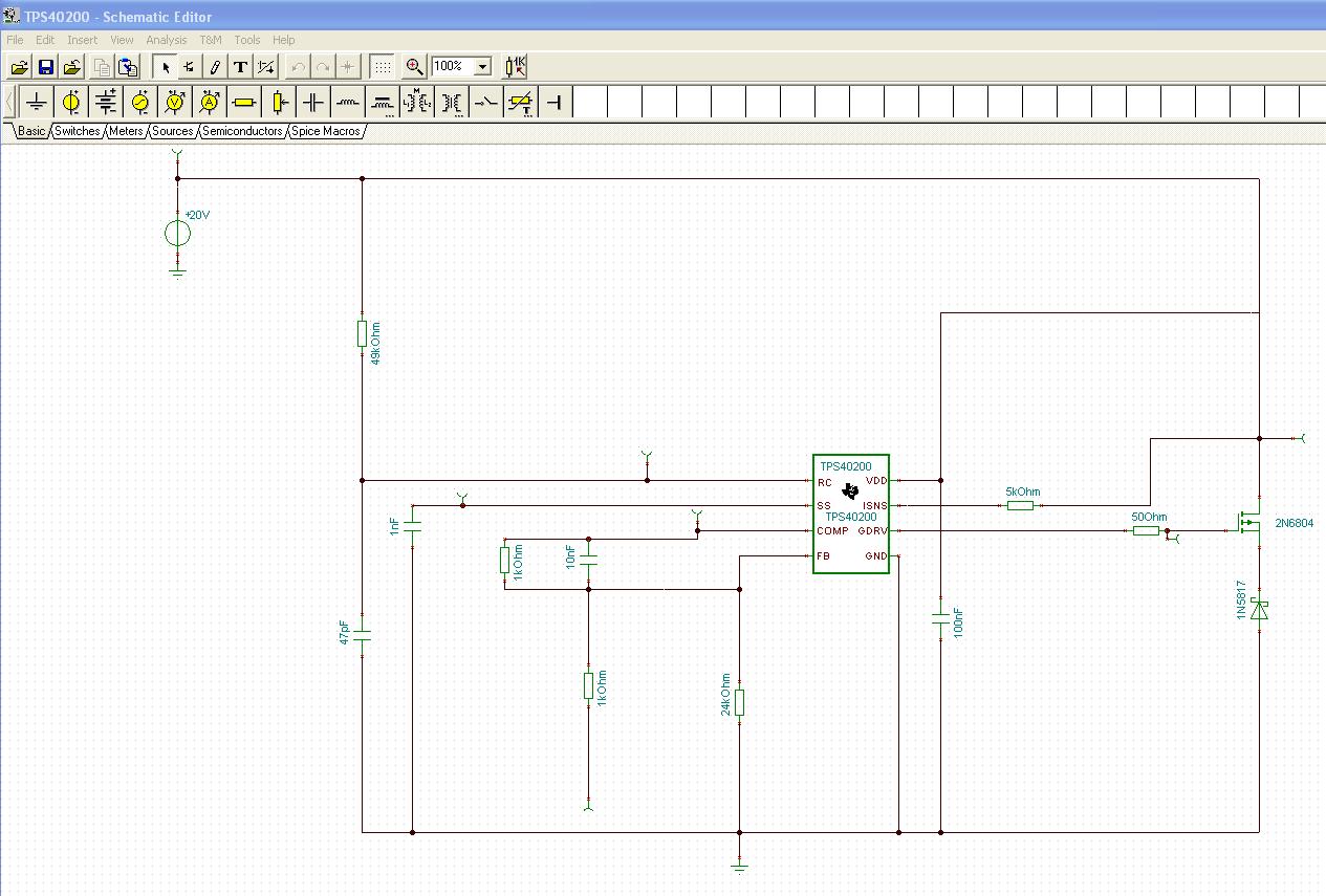

i´m doing simulations about SMPS-designing with TINA and the Controller TPS40200. I built my own circuit, similar to on of  the examples given by TI.
But i have still the problem, that an error occurs: Can´t find operating point. Even the TI-examples are running only in transient mode.

    at the attechment, there´s my circuit.
    I´d like to make a DC Transfer characteristic and furthermore calculating all DC results. But i´m not able to calculate the operating point and that´s way my simulation aborts.

  • Hi Kay,
    The model that was provided has a hard time finding the DC operating point. If you look at the analysis section shown above, you will see that instead of calculating the DC operating point, "Use Initial Conditions" has been selected to help the circuit converge.
    I also see that you have not developed the entire circuit around the part. Can you explain to me why you are trying to find the DC Operating Point for this partial circuit and what is your end goal?

    I´m trying to simulate the DC operation point just for this particular circuit, because i´d like to know  the output-behaviour and voltages. I have another stage afterwards and this isn´t working well. My end goal is strss-analysis for every  part.

    In that case, I would suggest that you run the transient simulation and let the output voltage settle down. The converter will always start from 0V (since no initial conditions are specified) and hence if you do the DC analysis in the simulator, you should get 0V (which is not what you are looking for). What you really need to do it run the transient simulation till steady state and note down the circuit voltage at that point. That will be the steady state  (DC) voltage that you are looking for.
