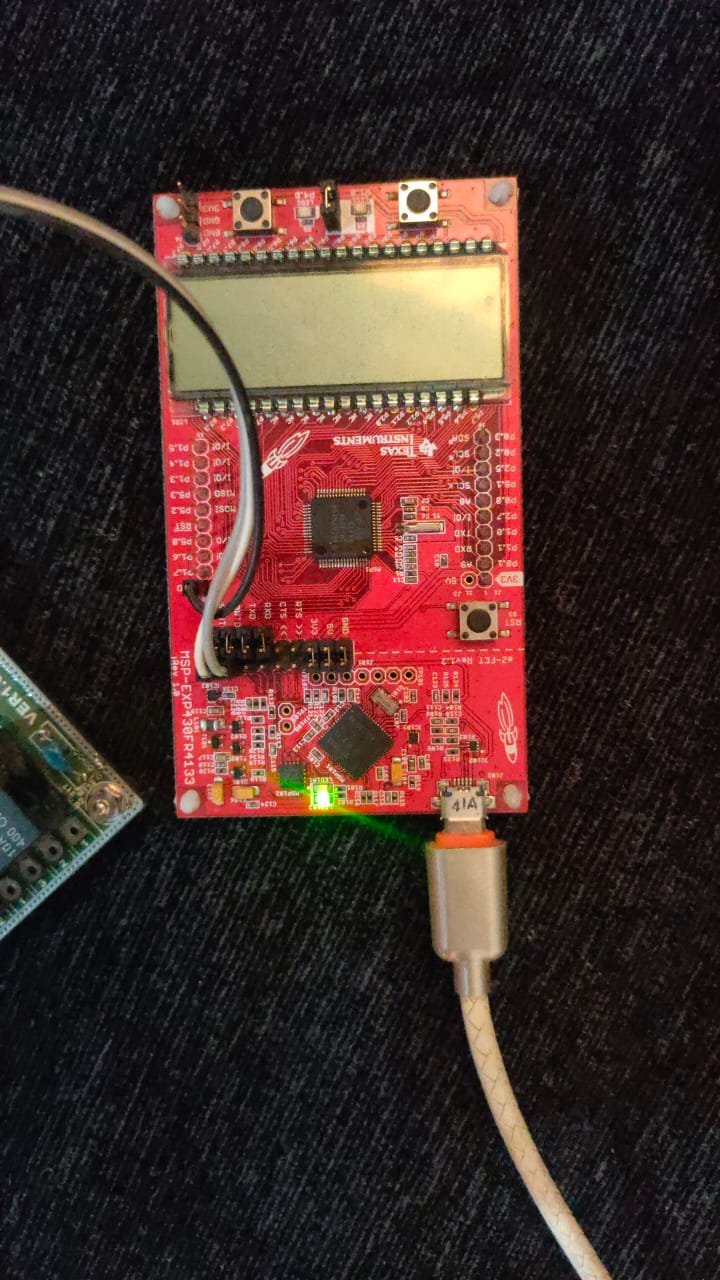

I'm using CCS version 10.1.1.00004 . I have MSP430FR4133 launchpad used as burner  into my controller which has MSP430FR2355 MCU and gate driver circuit (DRV8353RH). I am working on BLDC motor controller. I have TIDA-010056_Firmware_1.0 code which i am using for my project and i give 24v using adapter to controller. I am able to burn code into my controller but i didn't get any voltage across MOSFETs(inverter circuit).i do not connect BLDC motor yet. I want 20v across MOSFETs but didn't get it. Is there any interfacing problem??? please help me?!

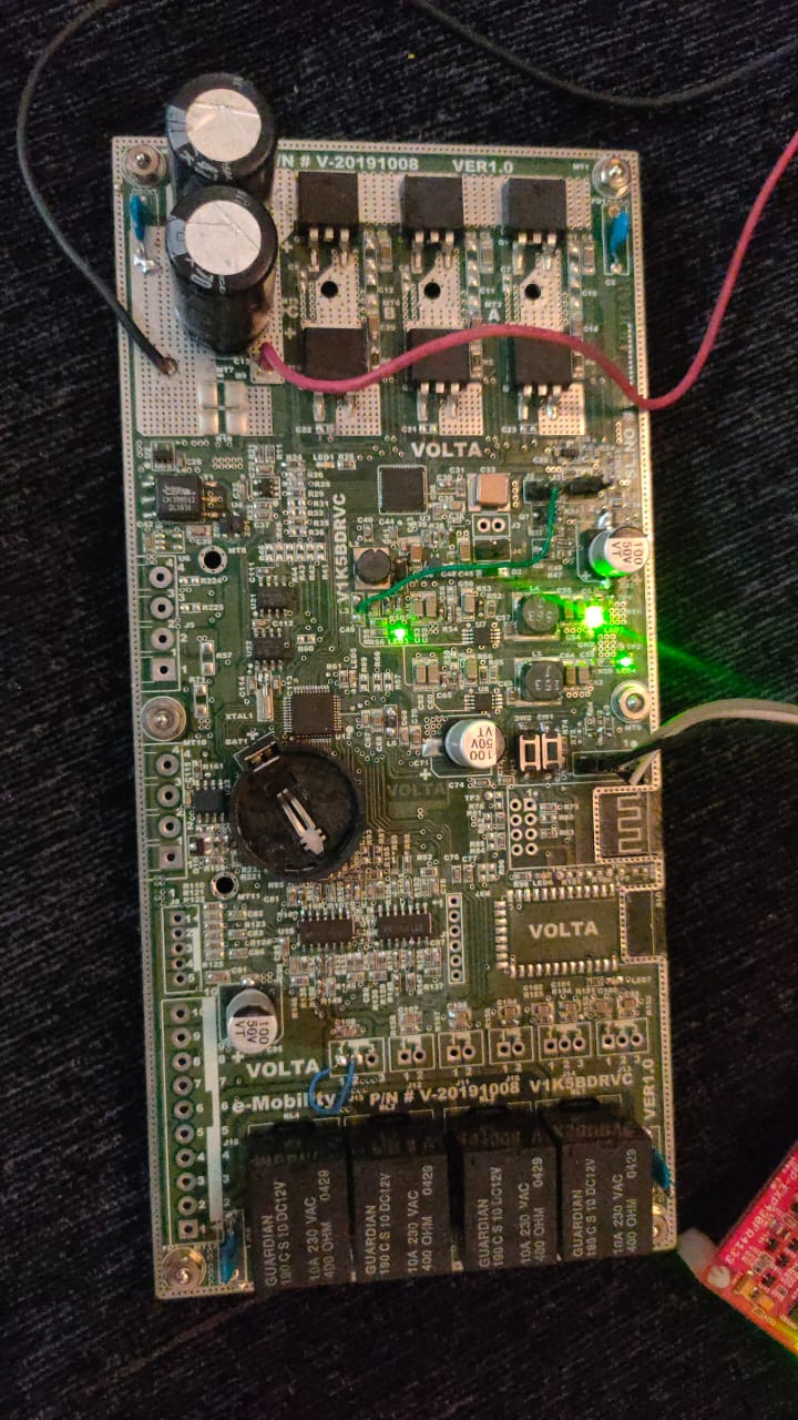

  • Hello Sudhir,
    Can you share your schematic file for us to look at?
    Which motor driver are you using? Is it the same one as in TIDA-010056 (DRV8350R)?
    Please check if the driver is powering ON by measuring the voltage at DVDD, VCP, and VGLS.
    Matt
  • We are using DRV8353RH as driver circuit in our hardware where as  we're using TIDA-010056 (DRV8350R) in software part...is it create problem??
  • Hello TI Helpers,
    Can you tell us, how to check voltage at DVDD, VCP and VGLS ?
    Thank you in advance.

     This is our main.c file . U can check it here also.
    As you can see in above pic P4.1 is used for enabling DRV circuit and P4OUT(in register) has logic high on p4.1. Now what is the problem..i don't get it.. please help me.
    Thank You.
  • Hi Sudhir,
    In order to test the DVDD, VCP, and VGLS voltages you will need to use an oscilloscope and probe the DVDD pin (pin 40) with respect to ground, VCP pin (Pin 7) with respect to ground, and the VGLS pin (pin 2) with respect to ground. If you don’t have any test points for those pins then you can try to use the capacitors connected to those pins as the probing points.
    You mentioned that you are using the DRV8353RH on your board but are using the code for the DRV8350RS, is that correct? The DRV8353RH is a hardware-based device, so it does not support SPI communication. The code that you are using is written for the DRV8350RS device which is a SPI supported device, so the code is written for SPI communication and would need to be modified to fit the hardware-based device of the DRV8353RH. The DRV8353RS is the SPI supported version for the DRV8353. Another thing to keep in mind is that there are some slight pinout differences between the DRV8353RS, DRV8353RH, DRV8350RS, and DRV8350RH devices so that must be considered when modifying the code.
    Anthony
