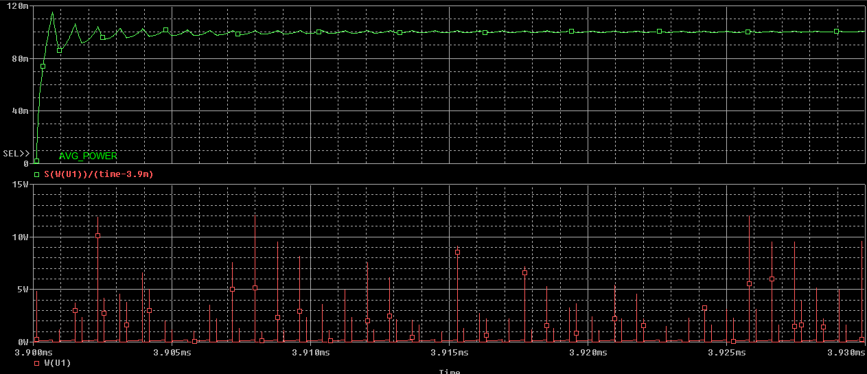

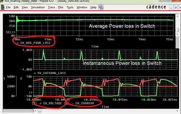

How can I rename the signal names on charts?
I have signals name of V(U1:1), I(R2) etc.... on x-axises. As I see, renaming of nets are not enough. The result is in format of V(NETNAME).
I would like to get readable names like this: "Average Power", "Input power", SW_AVG_POWR_LOSS etc... as in the picture below.
like this:

  • Hi JC,
    Text label is an other object. My target question talkes about changing of probe name.
    When I use complex formulas, then it can be usefull to use shorter names. How can I rename the red probe name below?
    As you can see, I can put text label to the sheet, but I can not rename the probe. Probe names could be more complex (and longer) and it is very problematic.
    I am thinking yet, maybe this feature is not available in "PSpice for TI".
    How peoples made it?
    Attila

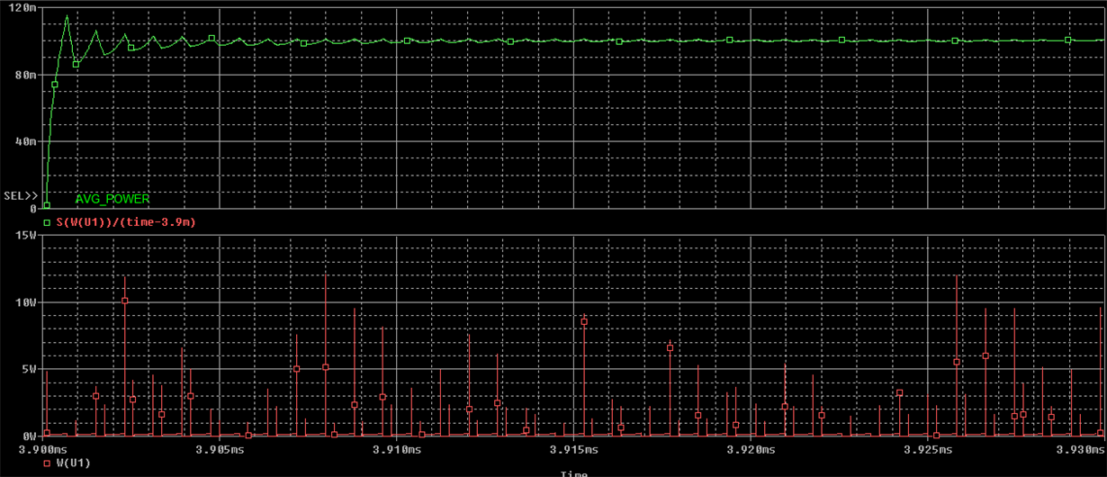

  • I have found the solution in manual.
    To replace probe names, it need to use a special syntax.
    <probe name>;<other name>
    e.g. Probe name is "S(W(U1))/(time-3.9ms)" and I would like to show is as label of "AVG_POWER", then I have to use this syntax under formula definition:
    "S(W(U1))/(time-3.9ms);AVG_POWER"
