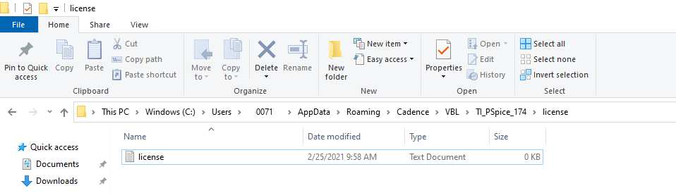

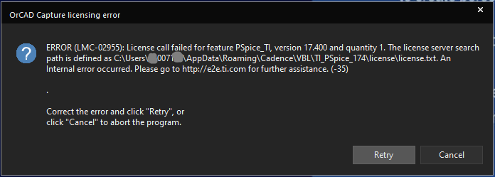

When I try to open Pspice for TI, Orcad Capture Licensing Error is coming.
The path shown in the error is available in my PC ( screenshot attached). How can I solve this.

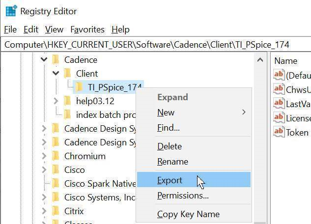

  • Hi Nesh,
    would you please export this registry setting to an text file and share it with us?
    In Windows search box, enter "regedit.exe" and execute the command.
    Find the key "Computer\HKEY_CURRENT_USER\Software\Cadence Design Systems\SPB 17.4" and export it like this:
    JC
