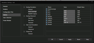

  • I presume you/cadence are talk about the below, if so, this has made no difference to me.
    I really need to get this working.
  • Hello Neil,
    Cadence has reported that the simulation completes after ~50 min with Autoconvergence enabled. I understand that this is not an acceptable sim time and we are further investigating.

    Cadence has recommended another option that worked for me. Download the attached file with additional simulation settings. In the PSpice for TI Schematic, please click the "Edit Simulation Profile" icon in the top toolbar. In the Simulation Settings, choose "Configuration files." For the Category, select "Include." For the filename, please choose "Browse..." and navigate to the include.txt file. Click "Add to Profile." The file should appear in the list of Configured Files. Click OK.
    Now try to run the simulation again. It took 2-3 minutes for mine to finish. Please let me know if you have any other trouble.
