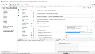

    You can configure advertisement mode with SysConfig on the peripheral side.
    For the entral side you should configure scanning, then implement some way to read out the information in the application.

    I read the doc in your link and BLE 5 stack user's guide, I did not find the answer, as in "simple_peripheral.syscfg", could you just tell me which selection is for "ADV_NONCONN_IND" and which is for "ADV_SCAN_IND"
    Michael
  • Hi Michael,
    To use ADV_NONCONN_IND select the non-connectable and non-scannable undirected advetisement.
