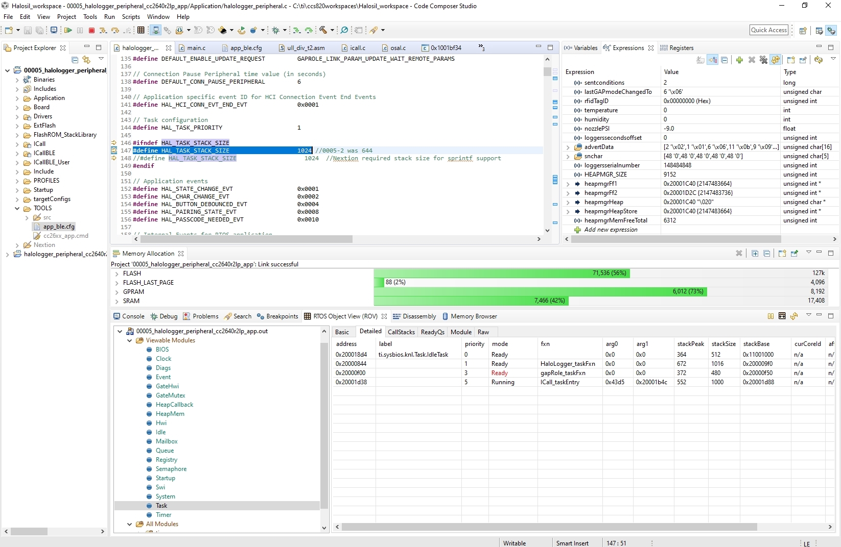

  • I increase the stack size to 1024 with this define:
    #define HAL_TASK_STACK_SIZE                   1024
    The stackPeak for HaloLogger_taskFxn is now a comfortable value of 672.
    But items #5 and #6 still persist as unexpected behaviors.
    Here is the Paused debug session at this stage:
    I can also report that at this stage, ROV reports hwiStackSize as 1024 and hwiStackPeak as 416.
    Where to go now ???
    Dale

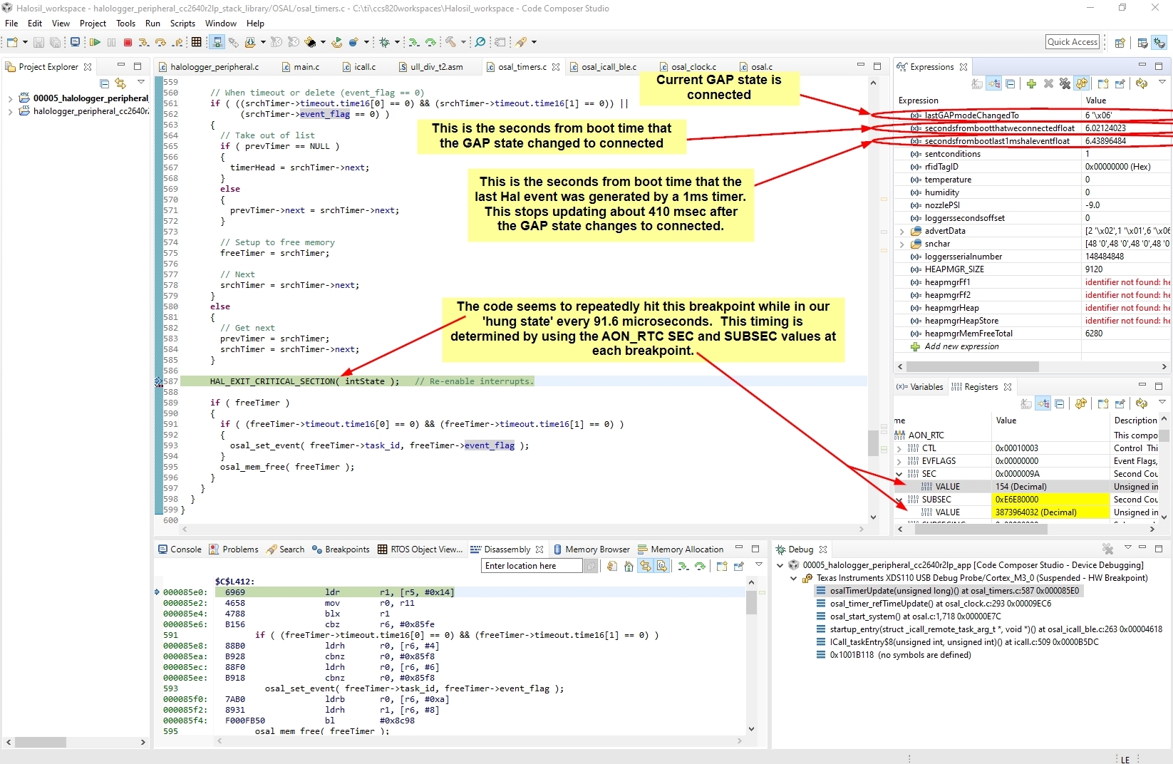

    EDIT: Here are more datapoints, I will continue the item numbering from my 1st post of this forum topic:
    8.  We have confirmed with a packet analyzer that at about the same time that Hal events stop, that a write of 0 0 0 0 1 appears which is what must have been sent from our IOS App on our 'Info' characteristic in item #5 of my first post.  Here is that packet analyzer listing:
    This data was never received by our R2F ported code since perhaps it may have been already in its 'hanging' state....
    9. Hal events trigger and the code breaks repeatedly at an active breakpoint on ‘events = Event_pend…’ while in the ‘advertising’ state but not ‘connected’ state, due to timer events.
    10.  We know that the R2F ported code is still running at item #7 and that this is NOT a simple hang because we can 'Pause' the code and it breaks at many different code locations.
    11. Single stepping the code after a ‘pause’ takes forever to find a 'repeat point' (I never actually single stepped enough to find that repeat point or realize that I had found a repeat point).
    12. During single stepping, it actually steps through many iCall code lines.
    I hope this sparks an idea in someone's mind as to where to investigate next ...
    Dale

    I am very familiar with debugging and the use of breakpoint limitations when using high optimization levels (in this case we use 4).  I have been debugging on Opt 4 for years with the un-ported CC2640F128 code.  My experience with breakpoints is that if you are allowed to set a breakpoint on a line of code and also that you can obtain a checkmark on the breakpoint in the 'Breakpoints' debugging tab, then the code will ALWAYS break there.  So when I say that the code does not break at a breakpoint in this forum topic, I mean a valid breakpoint that was set after the code was built and that there is a checkmark on the breakpoint in the 'Breakpoints' debugging tab.
    The breakpoints that I have mentioned so far have confirmed that prior to this 'hanging but running state' that we reach, we can break the code when Hal events are generated and that there is no reception of the info characteristic with value 0 0 0 1 by the CC2640R2F.
    Also, in this 'hanging state' code is running and is not in a simple loop since when we pause the code in a debug session, the code breaks at many different locations...
    Does any of this help or generate more ideas that we can look into for this issue?
    Is there a way to understand what code is actually being executed in the 'hanging state' more efficiently?
    Do the any of these code sections mean anything to you as to what is executing at this pause point? :

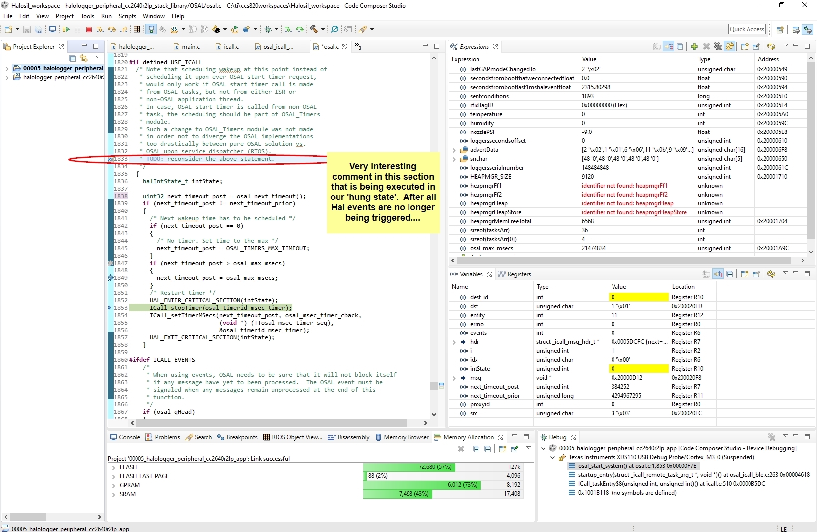

  • MORE INFO:
    I have been able to investigate our 'hung state' more but I am reaching the limit of what I can do here without further guidance.
    Here is a commented screenshot of may latest debugging attempt:

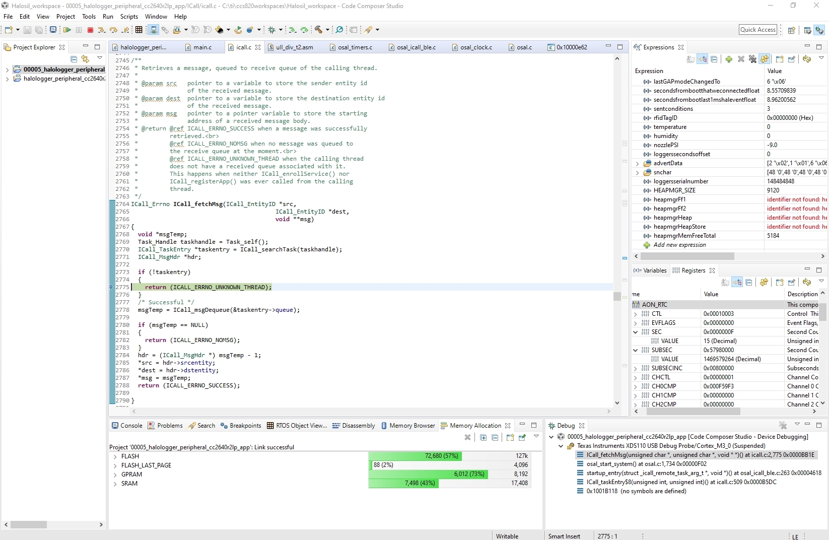

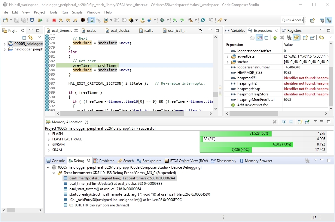

  • I decided to leave my ...CRITICAL_SECTION... breakpoint active after a forced board reset.  This would allow me to see what the code does during the initial advertising state where my 1ms Hall events are continually triggered.
    This breakpoint seems to be in the very basic code that controls all the processor tasks and it still breaks regularly in the advertising state with very little code executed between repeats of the breakpoint.
    This was encouraging, so I connected again and got back to our 'hung state'.
    Then I tediously single stepped between triggers of my ...CRITICAL_SECTION...breakpoint .
    Finally, I got to where an 'ICALL_ERRNO_SUCCESS' is generated as you can see below:
    Now, I have to believe that there is somebody out there that can tell me how to fix this error... please Pray
    EDIT: DARN, maybe that is not an unexpected error here Disappointed
    BUT: Here is another clue, maybe this is an unexpected error along the way while looping to find the highest priority task of the 9 active tasks in 'void osal_run_system( void )':

    Also, from their description, I can also reason that they likely do have an influence on whether an event may be triggered when new characteristic data arrives and possibly have an effect on Hall event generation.
    Are there any comments on this or any other rabbit holes I have gone down? Pray
    Dale
