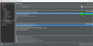

  • update, i added cc13x2_cc26x2_app.cmd  from  simple_peripheral_oad_offchip
    Build > ARM linker > File search path > Add path  ${COM_TI_SIMPLELINK_CC13X2_26X2_SDK_INSTALL_DIR}/examples/rtos/CC26X2R1_LAUNCHXL/ble5stack/simple_peripheral_oad_offchip/tirtos/ccs/cc13x2_cc26x2_app.cmd
    Now prgEntry = 0x50, but Bim still not start a new image ...

  • Sorry for late reply, in my case i had two points change & get success !
    1. Add "CMD FILE PATH" from TI simple_peripheral_oad_offchip project (don't copy file way, must add path)
    2. All progrem flash ( bin / hex file) from UNIFLASH
    All progrem include BIM & your project code.
    Good Lucky !
