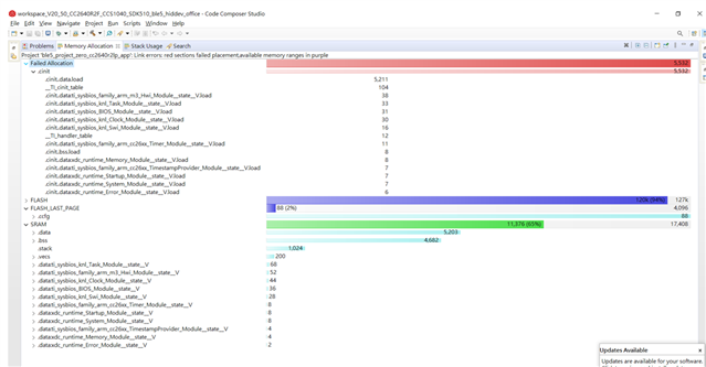

    Now I try to migrate the HID Mouse codes from BLE4 stack to BLE5 statck based on CCS 9.0.1, SDK 3.10.0.15, Project_Zero and CC2640R2F
    Need few days to migrate and test it!
    Kevin
  • Hi Kevin,
    Got it. We look forward to hearing the results of your test. Let us know if there are any further questions once the tests are completed.
    Jan
  • Hi Jan,
    Now I try to compile the HID Mouse codes based on BLE5 stack as followings,
    (1) Working Enviroment:
    - CCS 10.4.0,
    - SDK 5.10.0.2
    - Project : C:\ti\simplelink_cc2640r2_sdk_5_10_00_02\examples\rtos\CC2640R2_LAUNCHXL\ble5stack\project_zero
    - Board: LAUNCHXL-CC2640R2
    (2) Result: got the MEMORY management issue after compilation, (some HID SEVICES be added in)
    It seems that some extra HID SEVICES had been added in to PROFILE folder, right?
    (3) Any suggest on HID Sevices added?
    Kevin
  • Hi Kevin,
    The BLE5 stack does consume a lot more memory than the BLE stack, so this is likely the reason that the device has ran out of space. I recommend looking through the profile list and removing the ones that are not needed for your usecase. This will help free up some memory. You may find the following threads useful:
    https://e2e.ti.com/support/wireless-connectivity/bluetooth-group/bluetooth/f/bluetooth-forum/707553/launchxl-cc2640r2-running-out-of-flash-space
    https://e2e.ti.com/support/wireless-connectivity/bluetooth-group/bluetooth/f/bluetooth-forum/728227/launchxl-cc2640r2-reduce-flash-size-on-ble5-simple_peripheral
    https://e2e.ti.com/support/wireless-connectivity/bluetooth-group/bluetooth/f/bluetooth-forum/632265/rtos-cc2640r2f-is-there-a-way-to-reduce-flash-size-used-by-ble-stack-and-ti-rtos
    Jan
  • Hi Jan,
    1. I comment out three services of button_service, data_service and led_service in project_zero.c
        then passed compilation it seems the momory consuming issue fixed
    2. Due to some other topics coming urgently
        My BLE HID MOUSE project is pending here although still had problems waiting to conquer
        I would like to close this thread now!
