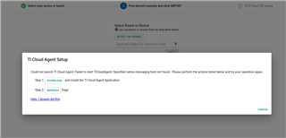

    # Attempt to use the code composer studio cloud
    Navigate to this [page](https://www.ti.com/tool/CCSTUDIO?utm_source=google&utm_medium=cpc&utm_campaign=epd-der-null-code_composer-cpc-evm-google-wwe&utm_content=code_composer&ds_k=code+composer&DCM=yes&gclid=CjwKCAjwzruGBhBAEiwAUqMR8KP37uaqheezEAMLqOMmzOviLcSnPqL5-UMlf53zGcVSR3p7QW157hoCk5QQAvD_BwE&gclsrc=aw.ds)
    Select code composer studio cloud
    It gives some errors about non existing pages and eventually lands on ti dev tools page.  It says on the page that for best experiences ti cloud agent needs to be installed.  I have not removed the extension so I'm not sure if that is a general message or an error where it detects a missing or misconfigured agent extension.  Ignoring that I click on the "Create project online".
    It moves to this page.
    Perhaps this is expected since I deleted the /home/davis/ti directory.  Click the download button to install the app.  It asks to choose a install directory.  By default it goes in the /home/davis directory.  Sure enough I have a /home/davis/TICloudAgent directory.  Also at the end of the install process it instructs me to plug in the LAUNCHXL-CC2650 eval board.  It seems to detect the board correctly since the install completes.
    Reload the new project page for ccstudio cloud online.  It installs file and then hangs.  See screenshot.
    Close tab and reclick the ccstudio cloud from the TIDevTools webpage.  This time it simply displays and unknown error occured.  See screenshot.
    LOL, this is amusing.
    Open a new chromium browser window and try again.  This time it works.  My board is detected and this screen appears.
    Before you get excited, take note that it says REV 1.0 in the UI but on the board it says CC2650 Launchpad Rev 1.2.   That does not leave me confident its working properly.
    Anyway click "use my board" and then click next.  It shows the next screen
    I select the minimal footprint example and click through the various next dialogs and it comes to this page where it hangs.  Oddly it says I have accepted 4 of 2.  Not feeling confident in the software quality at this point.
    Close the tab and try again.  It hangs on an untitled page once I click on the import button.  LOL
    Close the window, open a new one, navigate to code composer studio online, detect board, select import of minimal project example again.  Locks on a blank webpage.
    Code Composer Studio Cloud is unusable on Linux.  Punt.
