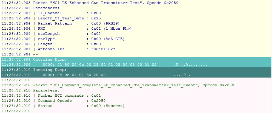

Hi,Team,
I used two LAUNCHXL-CC26x2R1s and an AOA boosterpack to preview the DTM. The one LAUNCHpad is to be receiver and has mount with AOA boosterpack; the other one is to be transmitter. I rebuilded the ble5stack example “host_test”project(the symbol RTLS_CTE_TEST has been pre-defined) and loaded hex files to launchpad respectively. For launchpad with aoa booterpack, I have moved C14 to C24 to select JSC ant and moved C12 to C15 to use GND to filter the PCB Ant signal.
When everything is ready,as shown in FIG, I sent DTM HCI command according to BLE core v5.2 spec . When I used a logic analyzer to measure DIO27, DIO28, DIO29, DIO30 by referring to the antenna switch truth table, I found that either the antenna array #1 or #2 was not switched continuously in the entire test period. For detail, only when I finished sending the command "HCI_LE_Receiver_Test" , the antenna array switch only for a moment. If this is the case, the DTM AoA CTE receiver test will not be convincing.

    Could you please provide a logic trace of the antenna switching? It would also help if you could provide a BLE trace.
    The test mode, enables the sender to send LE test packets with appended CTEs. In other words, the CTEs are not transmitted continuously.
    The antenna switching only occurs during the reception of the CTEs. No antenna switching is expected to occur outside of the reception of the CTEs.

    The logic trace of the antenna switching is shown in the figure below, which is one of the traces between DIO28~DIO30. I personally think that when I sent the command "HCI_LE_Transmitter_Test [v3]", the sender will send LE test packets with appended CTEs continuously until the command “HCI_LE_Test_End” is to be sent. So the receiver will receive LE test packets with appended CTEs continuously and will filter out other LE test packets.

    When it comes to DTM, I think your understanding is correct - the command HCI_LE_Transmitter_Test command allows you to send out the LE test packets with appended CTEs until you call HCI_LE_Test_End.When using HCI tester, the commands Send_HCI_LE_Enhanced_Cte_Transmitter_Test , Send_HCI_LE_Enhanced_Cte_Receiver_Test and Send_HCI_LE_Test_End are the proper commands.
    To be clear, these commands do not send an uninterrupted tone. I would recommend to review the BLUETOOTH CORE SPECIFICATION Version 5.2 | Vol 6, Part F, §4.1.7, to clear all remaining doubts regarding LE direct test mode.
