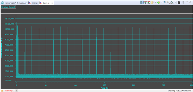

  • Please find some additional information for your understanding.
    I have conducted a test case where master is a samsung note 20 ultra mobile and slave is LAUNCHXL-CC26x2R1 launchpad. Below connection parameters were set on the slave side.
    Connection Update Request Params
    Parameter Update Delay (ms)                  :             2000
    Requested Min Conn. Interval (ms)         :             50
    Requested Max Conn. Interval (ms)         :             100
    Requested Slave Latency                           :             140
    Requested Conn. Timeout (ms)                :             32000
    Conn. Int selected by master (ms)           :             87.5
    Actual conn. Int with slave latency (ms)  :             12250
    Notification interval (ms)                          :             12250
    Please find the below sniffer output captured using another LAUNCHXL-CC26x2R1 running sniffle_cc26x2r.out firmware. For example, the frame 736 corresponds to connection interval as well as notification interval since both are same in this case. Ideally I would expect just empty PDU at this instant from slave if there is no actual data. But, notification data was exchanged as we have notification data. Right after this in the frame pair 738-739 channel map update happened. Again we have empty PDU exchange in the frame pair 740-741. I understood from the parent issue that this additional empty PDU is due to some handshaking procedure. However, this empty PDU exchange did not stop here. Further, If we look at the next connection event at 38.270214 sec notification data has been exchanged. Again, two more empty PDU exchanges can be observed right after this in 882-883 and 888-889 message pairs. This scenario is really uncertain because slave latency is completely ignored and it is raising lot of concerns about the products battery life. Hope this explanation gives clear idea about our concerns. Sniffer output.zip
