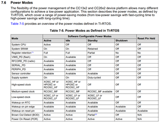

  • To narrow down what could be holding off the standby mode, try checking the PRCM registers.
    Specifically, PDSTAT0 and PDSTAT1 that show which power domain is enabled.
    This can then be mapped to the power modes table in the TRM section 7.6.
  • As Advised observed the PRCM registers,PDSTAT0 and PDSTAT1. we noted that, when sensor ODR is 1600Hz, PERIPH_ON, SERIAL_ON, RFC_ON bits of PDSTAT0 are toggling 0 and 1. and when Sensor ODR is 3200Hz,PERIPH_ON, SERIAL_ON bits of PDSTAT0 are always 1(Domain powered up) , RFC_ON is toggling?
    is this the reason MCU not going to standby? can we get more details on the conditions of the above registers operation?
    How can we debug this further?
