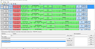

  • I have TI SmartRF sniffer ,but when I try to catch details during connection interval .
    Observation:
    There is no separate information for connection parameter configuration during connection establishment.only change I observe is Adv PDU type is changed.
    May I know how to view connection establishment details in TI SmartRF sniffer?I am new with this Tool.
    Is sniffer 2 is needed for this (currently I am using cc2640 dongle) ?
    May I know ,What is the time taken for performing configuration of the parameters necessary for the connection establishment?
    The TI SmartRF sniffer can only sniff advertising packets. In this case, we need to sniff all the BLE traffic in order to determine what is going on exactly during connection establishment. To measure the BLE traffic, then you would need a dedicated BLE traffic sniffer such as an Ellisys or a Frontline sniffer. Having these sniffer will allow for greater debugging capabilities in BLE development. The time for connection establishment, should be the time between the connection is initiated and when the GAP_LINK_ESTABLISHED_EVENT is received on the device.
