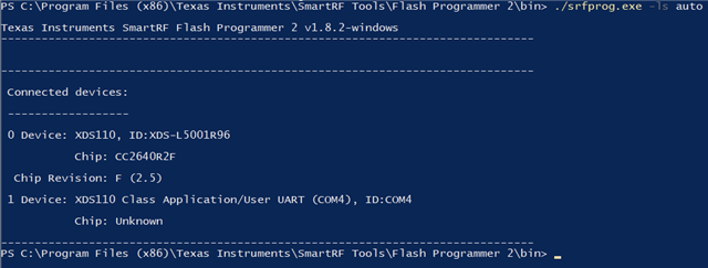

  • Eric,
    You can use the SmartRF Programmer 2 CLI to do this. Use this command:
    ./srfprog.exe -ls auto
    and it will return the connected devices and attempt to read the device ID:
    Daniel
  • Eric,
    Here is the output showing that the tool can detect between the R and RB device:
    C:\Program Files (x86)\Texas Instruments\SmartRF Tools\Flash Programmer 2\bin>srfprog -ls auto
    Texas Instruments SmartRF Flash Programmer 2 v1.8.2-windows
    Connected devices:
    0 Device: XDS110, ID:XDS-76543210
    Chip: CC2652RB
    Chip Revision: E (2.1)
    1 Device: Intel(R) Active Management Technology - SOL (COM3), ID:COM3
    Chip: Unknown
    2 Device: XDS110 Class Application/User UART (COM6), ID:COM6
    Chip: Unknown
    Connected devices:
    Chip: CC2652R
    Chip: Unknown
    Chip: Unknown
