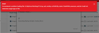

I used to program the OAD files in my CC2640 by IAR + Uniflash as descripted in the UG. It works, but not convenient.
Now, I want to use Uniflash to program the OAD files (BIM, Stack, Persistent, and App) to CC2640. I tried few times, however, it doesn't work.
I think the address for BIM and Stack must be incorrect. Could you tell me what the value here for each one? And where is in the code to define these address? All the codes are originally simple_peripheral_oad_onchip base on sdk_5_10_00_02.

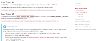

  • Hi Victor,
    This is known as Creating a Production Image and is also covered in the BLE Enhanced OAD SimpleLink Academy Lab.
    Ryan
  • Hi Ryan,
    Thank you for your kindly help. I'm also sorry for reply late.
    I can' find the answers in the related sources, it seem like all of these contents are based on off_chip_oad.

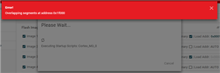

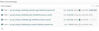

  • Hi Ryan,
    I tried few times by Uniflash with different address, binary type (hex or bin), it failed for different error. I'm pretty sure that all these binary code are ok. I think there might be some mistake about the program sequence, address, and binary type (hex or bin) selection.
    It would  be very nice of you, if you could explain more detail about Uniflash program. I would appreciate it very much if you could attach a screenshot of Uniflash.
    Thank you.
    Victor Chu
  • Hey Victor,
    I will look into this and follow up soon. In your most recent screenshot, it looks like you are also flashing the persistent image stack binary, but you do not select an address. This could be the source of the issue.
  • Hi Ammar,
    I absolutely agree with you. I actually know there must be something wrong with the address, but don't know how to fix it.

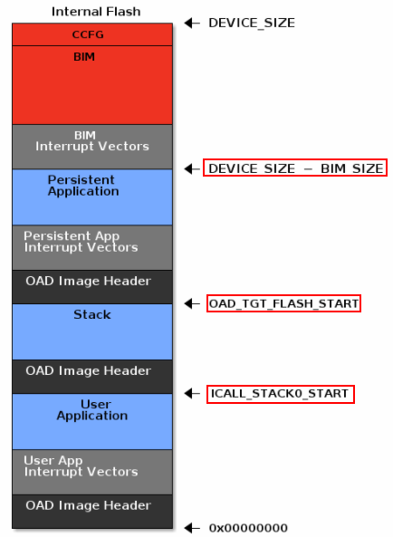

  • Hey Victor,
    I would take a look at the .map files generated for each project, and you will get an idea of where things are placed in memory. Additionally, you can refer to the .cmd files for the memory map (in code). I would cross reference the projects together with our documentation provided to get a better understanding of how they all tie together and are mapped out.
    Please let me know if you have questions along the way, I apologize as I have not had time just yet to investigate this.
  • Hi Ammar,
    I understand your situation.
    Thank you for the clues. I found the definition of ICALL_STACK0_START, OAD_TGT_FLASH_START in the *.xcl files under config. But I still cannot find the definition for DEVICE_SIZE and BIM_SIZE which is of BIM's start address. Could you tell me where they are?

  • Hey Victor,
    You'll have to check the cc26xx_bim_r2.cmd file for more details on the BIM memory map (i.e. BIM_SIZE).
