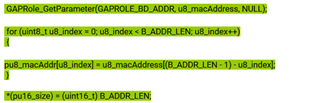

I have an old procedure  for CC2640R2
 GAPRole_GetParameter(GAPROLE_BD_ADDR, u8_macAddress, NULL);
 for (uint8_t u8_index = 0; u8_index < B_ADDR_LEN; u8_index++)
pu8_macAddr[u8_index] = u8_macAddress[(B_ADDR_LEN - 1) - u8_index];
 *(pu16_size) = (uint16_t) B_ADDR_LEN;
GAPRole_GetParameter is defined in multi.h in  simplelink_cc2640r2_sdk_5_10_00_02 for CC2640R2 but in simplelink_cc13x2_26x2_sdk_5_20_00_52 for CC26x2R1 multi.h is discarded and lot of  API's also changed .
I see that in migration of CC2640R2 to CC26X2R1 the API  GAPROLE_BD_ADDR is changed to HCI_ReadBDADDRCmd() I see it's working as it is returning only HCI_Success but it not giving any BLE MAC address .
Can you suggest me the method to get the BLE MAC Address (as of I have mentioned for CC2640R2  in green) and the API's exactly related to it in detail please.
