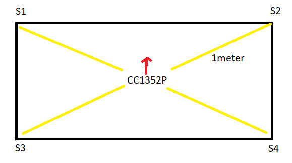

Recently I have planned to use SMA antenna for some automotive related project to receive signals from 4 sensors using BLE. We have planned to use SMA Antenna and as per TI's  input I did the chnages in capacitance orientation to change the track. The antenna is working fine but its performance is worst. I am unable to connect 4 sensors or the received data is very less.
While when I check the same using Patch antenna available on Launchpad the performance is near about ok.
Can you please tell me the reason for this. I am using 5dBi antenna Link - Buy 2.4GHz 5dBi Omni Wi-Fi Booster SMA Male Antenna Online (robu.in) .
I am using the same inside the Vehicle to test but the results on SMA are Poor than Patch. We cannot use patch antenna.
Do you have any antenna that can give best results with CC1352P launchpad or any other suggestions on different types of antenna.

  • This antenna which I used I think is Monopole antenna. Do you think it will effect the performance also its a 5dBi antenna. We have sensors placed below our Launchpad 1m apart from each other and are 4 in quantity.
    Do you think buying a 2dBi dipole antenna will give better performance.

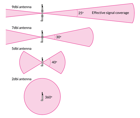

    Please have a look at this pic which I found on internet.
  • An antenna with a high gain will be more directive and hence the total performance will be dependent on how the antennas are placed relative to each other.
    With a 5 dBi antenna you will get better performance if the antennas are places correctly compared to 2 dBi antennas but if the placement/ direction is not optimal the loss will larger.
    Hence if you have control over how the antennas are placed relative to each other you can use high gain, if not, use lower gain.

    Do you think Using External Patch antenna will solve the issue instead of using Whip antenna as I was testing using Whip antenna.
    Distance is 1m from center as can be seen. I asked for 2 dBi because our sensors are placed all in 360 degree.
  • With 1 m, do you have metal from the Vehicle in between or is it line of sight?
    I need to know if this is a bad connection issue or placement of sensors within a car issue.
  • Hello TER,
    Yes We have metal. Its placed on the bottom of car chassis. All sensors are perfectly tuned.
    As this is a car would you suggest some another antenna.
