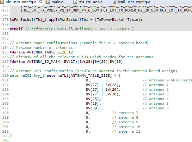

             Use A1.1 1.2 1.3 to collect signals from another cc26x2 as coordinator.
The python collection code and firmware code are modified with the following parameters:
Iq data is currently operational and collected, but it cannot match iq data with the antenna.
What does sample_idx= 46 mean in the figure above?
Iq transmitted by different channel should also not be able to calculate AOA.
The customer would like to know how to process iq data then can identify which antenna data is.
