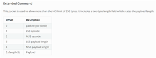

  • short explanation on what we want to achieve:
    In our setup we are sending SPI commands to the BLE chip using Host_test app (unmodified except the UNPI part). And we liked that we did not have to modify any of the embedded code and the best solution for us would be to keep it that way :).
    So up to now we were sending all commands with: Type: 0x01 (Command).
    From the code below my understanding is that if I send a command with Type: 0x09 (HCI_EXTENDED_CMD_PACKET) a 2 byte length will be expected. And this will not require any other modification in the code. Is this correct?
    static uint8_t processExtMsg(hciPacket_t *pMsg)
      uint8_t deallocateIncoming;
      bStatus_t stat = SUCCESS;
      uint8_t rspDataLen = 0;
      hciExtCmd_t msg;
      uint8_t *pBuf = pMsg->pData;
      // Parse the header
      msg.pktType = *pBuf++;
      msg.opCode = BUILD_UINT16(pBuf[0], pBuf[1]);
      pBuf += 2;
      if (msg.pktType == HCI_EXTENDED_CMD_PACKET)
        msg.len = BUILD_UINT16(*pBuf,*(pBuf+1)) ;
        pBuf+=2;
      else
        msg.len = *pBuf++;
      msg.pData = pBuf;
    Sorry for the delayed response.
    Yes, your understanding is correct. By using HCI_EXTENDED_CMD_PACKET, the payload length can be extended to 2 bytes. The detail of the payload is as below
    For more information regarding HCI, you can go to:
    SIMPLELINK SDK INSTALL/docs/ble5stack/vendor_specific_guide/BLE_Vendor_Specific_HCI_Guide/hci_interface.html
