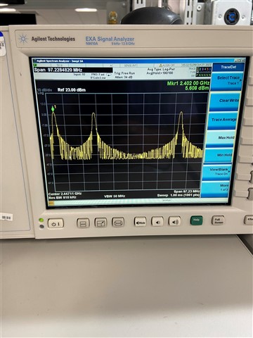

  • Hi Dawn,
    Is it possible your code is resetting the TXPower somewhere? I did some initial testing and I found that if I took an unmodified simple_peripheral example and simply called HCI_EXT_SetTxPowerCmd(HCI_EXT_TX_POWER_MINUS_21_DBM); on the key handler, I got the 26 dB power change I was expecting. I tested with a spectrum analyzer in the lab to confirm.
    I also ran it with energytrace and found that the current consumed does increase/decrease when the tx power is increased/decreased.
    Perhaps you can verify our setup too. It's just the simple_peripheral example with the extended advertising set removed, and the following change to the HandleKeys function in simple_peripheral.c (SDK 5.10 for CC2640R2).

    Pictures of Setup (5 dBm left, -21 dBm right). Ignore the spur at 2404 MHz in the right hand picture.
    Energytrace showing differences in peak currents

  • Hi Dawn,
    Here is a conclusive answer:
    For Advertising, Scan Responses and Connection - Use GapAdv_setParam()
    For the HCI_EXT_ModemTestTxCmd - use HCI_EXT_SetTxPowerCmd()
    Below is the waveform I was able to obtain by running my code where I just call GapAdv_setParam as above.
    This code toggles between 5 dBm and -20 dBm every time advertising stops (either because you push a button or because you're entering a connection interval. See in the screenshot how every time you enter a connection the current consumption changes. This shows to me pretty conclusively that calling GapAdv_setParam should be able to change the txpower for advertising, scan response and connection mode. I also monitored with a packet capture and confirmed through the RSSI that the packet sniffer measured.
    5 dBm advertising and scan response
    5 dBm connection
    -20 dBm advertising and scan response
    -20 dBm connection
