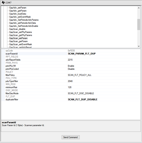

  • Hi Sen,
    After speaking with the R & D team, I have confirmed that the correct way to get the configuration you're looking for is to send the following command via BTool:
    Navigate to Advanced Commands -> GAP AE-> GapScan_setParam.
    Set scanParamId to SCAN_PARAM_FLT_DUP and duplicateFilter to SCAN_FLT_DUP_DISABLE.
    Now, when you scan, you will get a similarly high number of results.
    Nate
