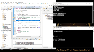

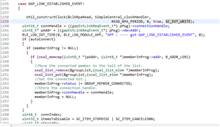

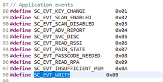

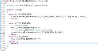

  • I created an event and called SimpleCentral_doGattWrite()  inside that event, right after GAP_LINK_ESTABLISHED_EVENT.
    Here is the screen shot of declaration, function call and function implementation.
    defining the value for new event created.
    function trigger inside the event created.
    function call after delay.
    Is this the right way to do it?
    I tried by this method, but I am not able to write
    The output in tera-term is as below:
    I tried verifying if the central is writing, by placing the breakpoint in peripheral code where it gets printed on tera term window, but I am not able to see any output.
  • Do you put a breakpoint on your SimpleCentral_doGattWrite in your SC_KEY_WRITE and make sure it is called?
  • yes, i checked that. In simple central, always the breakpoint hits SimpleCentral_doGattWrite() function and it executes completely. But neither Iam able to see the output " Write Sent : 0x00" in the tera term window of simple central, nor it is hitting breakpoint in simple peripheral and printing "Char 1: 0x00" in tera term window of simple peripheral.
    But the output is visible, if I do the same thing with button pressing operation.
