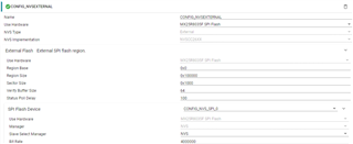

  • Hi Matthias,
    Thank you for these details.
    Could you please share the SysConfig configuration of the NV memory? Please also specify if you are using several NV regions or if you have modified them.
    Thanks and regards,
  • Hi Clément,
    here are the CSS screenshots of my sysconfig.
    It is the default simple peripheral offchip config for the launchpad without any modifications.
    If you need more datails, just let me know.
