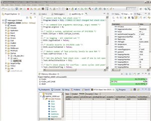

  • Here is a screenshot that shows that I have tried to do as you suggest but it does not look like ROV is telling me that the appBLE.cfg file I added to my workspace is being referenced since ROV still shows hwiStackSize as 1024:
    Did I put the appBLE.cfg into the correct folder of my workspace?
    Else, what next?
  • Also, in my app_ble_uartlog.cfg is this but as you can see by my code comment it has no affect on hwiStackSize:
    /* ================ Program configuration ================ */
     *  Program.stack is ignored with IAR. Use the project options in
     *  IAR Embedded Workbench to alter the system stack size.
    if (typeof NO_ROM == 'undefined' || (typeof NO_ROM != 'undefined' && NO_ROM == 0))
      Program.stack = 512; //20021-13 DALE changed stack size to 512 from 1024
      					   //BUT this did not change the ROV>hwi hwiStackSize of 1024
      Program.argSize = 0;
    else
    I am unable to put a breakpoint in this code, does that mean the code is never executed during a debug session?
