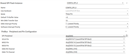

    Its not with Winbond devices, we now checked with the external  MX25R8035F 1Mb spi flash also
    With that also its not working
    and  When we are comparing Internal SPI flash and External Spi flash Config We can see the below differences
    1.Region Size is increased in external
    2.In Spi Flash config we can see launchpad spi is selected
    Below is our Queries
    1.Why Region size is increased?
    2.Why Launchpad spi is being used and two spi configs are available?
    3.Also we have tried same MX25R8035FZUIL0 SPI flash via connecting as external, but still we are not able to read / write. Is there any other HW requirements needed?
    4.We also have tried NVSexternal instead of spiffsexternal there we are able to read / write What is the major difference between NVS external and spiffsexternal?

    Also Please check this below image also
  • 1. External Region Size is utilizing all 1 MB of MX25R8035F SPI flash, which is not available internally on the CC2642R (352 kB total)
    2. Internal NVS configurations do not use a SPI config, External options can choose one of the two SPI peripherals available on the device.  Default external examples use the available LaunchPad SPI configuration to interface with the on-board external flash device.
    3. Are you using the same connections as the LAUNCHXL-CC26X2R1 design files?  What changes are applied to the default example's SysConfig file?
    4. FFS implements a Flash File System using the Non-Volatile Storage (NVS) driver as the interface.  The NVS implementation of either default example appears to be identical.
    Please make sure to reference each example's README to understand more about its intended operation.  Which SimpleLink SDK version are you referencing?  If you are able to observe issues using a LAUNCHXL-CC26X2R1 then please share what steps can be used to recreate the behavior.
    Ryan
  • Hi
    We have checked all the possible ways from our side. Onboard flash is MX25L6433F 1MB which is working fine for us and the spi flash which we need to use is Windond W25Q32JV 4Mb flash which shows error in mounting.
    From our brainstorming we confirmed that there is no issues with winbond devices
