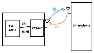

  • Hi Nate,
    The error message is coming from CC2640 when I'm trying to send a notification to smartphone. I can receive a 20+ byte message from smartphone correctly.
    To better illustrate, the following figure shows my setup.
    BR,
    Eduardo.
  • Thank you for the clarification and the diagram Eduardo!
    It looks like the notification you're trying to send in handle 0x0003 is too big for the memory allocated, or for some reason you're overwriting off past the end of the characteristic. If you're not sure where the problem is, I'd recommend starting by testing host_test with the BTool setup to ensure you're sending the proper commands between host_test and external processor.
