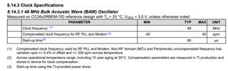

Hi FI,
My customer is working on a water meter featuring the CC2652.
They need long time stability as the working time is expected around 12 years.
What is the ppm deviation of the BAW in the long term? Is that something we have modelled?
Thanks and best regards,
Juan.
Per the datasheet the ppm is +/-40 ppm at 30C over 10 years.
regards
