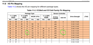

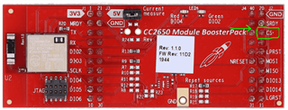

I am trying to use ADC in CC2650MODA. I am using pin IOID 9 in cc2650MODA to acquire values. I am applying 1.65v across the IOID 9 pin and I am getting an ADC value of 4.
I have modified the board. h and CC2650Launchxl.c file to configure IOID 9 pins. But I couldn't able to acquire the proper value.
Modifications in CC2650Launchxl.c file,
const ADCBufCC26XX_AdcChannelLutEntry ADCBufCC26XX_adcChannelLut[] = {
    {PIN_UNASSIGNED, ADC_COMPB_IN_VDDS},
    {PIN_UNASSIGNED, ADC_COMPB_IN_DCOUPL},
    {PIN_UNASSIGNED, ADC_COMPB_IN_VSS},
    {Board_DIO07_ANALOG, ADC_COMPB_IN_AUXIO7},
    {Board_DIO08_ANALOG, ADC_COMPB_IN_AUXIO6},
    {Board_DIO09_ANALOG, ADC_COMPB_IN_AUXIO5},
    {Board_DIO10_ANALOG, ADC_COMPB_IN_AUXIO4},
    {Board_DIO11_ANALOG, ADC_COMPB_IN_AUXIO3},
    {Board_DIO12_ANALOG, ADC_COMPB_IN_AUXIO2},
    {Board_DIO13_ANALOG, ADC_COMPB_IN_AUXIO1},
    {Board_DIO14_ANALOG, ADC_COMPB_IN_AUXIO0},
const ADCCC26XX_HWAttrs adcCC26xxHWAttrs[CC2650_LAUNCHXL_ADCCOUNT] = {
        .adcDIO = Board_DIO07_ANALOG,
        .adcCompBInput = ADC_COMPB_IN_AUXIO7,
        .refSource = ADCCC26XX_FIXED_REFERENCE,
        .samplingDuration = ADCCC26XX_SAMPLING_DURATION_2P7_US,
        .inputScalingEnabled = true,
        .triggerSource = ADCCC26XX_TRIGGER_MANUAL
        .adcDIO = Board_DIO08_ANALOG,
        .adcCompBInput = ADC_COMPB_IN_AUXIO6,
        .adcDIO = Board_DIO09_ANALOG,
        .adcCompBInput = ADC_COMPB_IN_AUXIO5,
        .adcDIO = Board_DIO10_ANALOG,
        .adcCompBInput = ADC_COMPB_IN_AUXIO4,
        .adcDIO = Board_DIO11_ANALOG,
        .adcCompBInput = ADC_COMPB_IN_AUXIO3,
        .adcDIO = Board_DIO12_ANALOG,
        .adcCompBInput = ADC_COMPB_IN_AUXIO2,
        .adcDIO = Board_DIO13_ANALOG,
        .adcCompBInput = ADC_COMPB_IN_AUXIO1,
        .adcDIO = Board_DIO14_ANALOG,
        .adcCompBInput = ADC_COMPB_IN_AUXIO0,
        .samplingDuration = ADCCC26XX_SAMPLING_DURATION_10P9_MS,
        .adcDIO = PIN_UNASSIGNED,
        .adcCompBInput = ADC_COMPB_IN_DCOUPL,
        .adcCompBInput = ADC_COMPB_IN_VSS,
        .adcCompBInput = ADC_COMPB_IN_VDDS,
Modifications in CC2650Launchxl.h file
#define Board_DIO07_ANALOG          PIN_UNASSIGNED
#define Board_DIO08_ANALOG          PIN_UNASSIGNED
#define Board_DIO09_ANALOG          IOID_9
#define Board_DIO10_ANALOG          PIN_UNASSIGNED
#define Board_DIO11_ANALOG          PIN_UNASSIGNED
#define Board_DIO12_ANALOG          PIN_UNASSIGNED
#define Board_DIO13_ANALOG          PIN_UNASSIGNED
#define Board_DIO14_ANALOG          PIN_UNASSIGNED
Modifications in Board.h file
#define     Board_ADC0              CC2650_LAUNCHXL_ADC2
What might be the issue?

    Our team has reproduced this issue (DIO9 seems to not work with ADC) on BOOSTXL-CC2650MA, and are investigating potential causes.
    Can you try configuring DIO9 as output GPIO? I wonder if it could be an issue with the board itself.
    Toby
  • No, I try to use DIO9 as GPO and it doesn't work at all. PIN_getOutputValue from DIO9 always return 0 eve I set it to high by using PIN_setOutputValue.

    I test DIO9 as GPO and I cannot control it to high. DIO9 is always low in my GPO test. I can test DIO9 as GPI too to see if it works. However, can you also test if GPO function works on DIO9 of your BOOSTXL?
    , thanks for confirming on your end.
    I am able to configure DIO9 as output, and can see with logic analyzer that I can toggle it high and low.
    Can you confirm that you are measuring DIO9 on the pin labeled "CS" on silk?
    (Just want to make sure, since I noticed that DIO9 has an alternate path (if R21 is populated) to a different board header).

  • Hi all,
    I believe the issue is the mapping between AUXIO# and DIO# for DIO 9 and DIO 10.
    After making the below changes, I am able to read ADC values from both DIO 9 and DIO 10:
        {Board_DIO9_ANALOG, ADC_COMPB_IN_AUXIO4},
        {Board_DIO10_ANALOG, ADC_COMPB_IN_AUXIO5},
        { // working!! (DIO9 -- AUXIO4)
            .adcDIO = Board_DIO9_ANALOG,
        { // working!! (DIO10 -- AUXIO5)
    Please try these changes and let me know if they are working for you.
    Toby
  • 1. For DIO9 as GPIO, the root cause of not working is that I remove R20. I make it work after I solder R20 back.
    2. After use AUXIO4 for DIO9 and AUXIO5 for DIO10, both ADC reading from DIO9 and 10 are correct now. Can you elaborate why we have to switch AUXIO for DIO 9 and 10?
  • This is actually documented in the TRM:
    The required AUXIO# and DIO# mappings for each package are shown here.
    The ADC example was based on 7x7 package, which has different AUXIO# to DIO# mapping -- CC2650MODA is based on 5x5 package, so please refer to the 5x5 mappings.
  • This is weird that those two AUXIOs are not in sequential order as others when you design hardware. Anyway, it’s good to figure out all of these.
