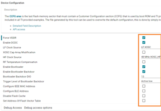

  • Hi Ammar,
    Thanks for your support again!
    The SDK they use is version 5.20, and they can  configure CCFG in simple_peripheral_oad_onchip.syscfg, please see the figure below:
    Cherry
  • Hey Cherry,
    After further inspection, although these options appear to be configurable using SysConfig, you'll find that the tool does not generate the required files (ti_devices_config.c) to override the entries. This means that any change in SysConfig will not be made to the CCFG for the simple_peripheral_oad_onchip application.
    This is a bit misleading, but it looks like during the last SDK update to 5.30 we have addressed this.
    Hope this helps.
  • Hi Ammar,
    Thanks for your help again! It did resolve the issue here.
