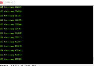

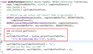

I tried the example “adcbufcontinuous_CC2650_LAUNCHXL_TI”, I set the “adcBufParams.samplingFrequency = 1000;” and “#define ADCBUFFERSIZE    (25)”. And I add some code in ADC callback function to print the time stamp, as the picture.
The callback function should be executed every 25ms, however the timestamp it prints show it executes every 24.85ms.
I was really confused why the time is less than 25ms,since 25*0.001=0.025s.

    OSCClockSourceGet 1:
    freq: 0,48000000
    1 timestamp 2194:
    2 timestamp 4693:
    40 timestamp 99705:
    41 timestamp 102204:
    80 timestamp 199716:
    81 timestamp 202218:
    "OSCClockSourceGet 1:" shows that I successfully set the clock source to XOSC_HF, and the CPU frequency is 48MHz. And I have a problem that when it need to change the CPU frequency? since XOSC_HF is doubled internally to create a 48-MHz clock, maybe I don't need to change CPU frequency?
    As for the timestamp, it takes 24.99ms~25.02ms for every packet, which is more accurate. However, 102204-2194=100010=1000.1ms and 202218-102204=100,014=1000.14ms. and I checked many times, the time for every 40 packet is 1000.1ms~1000.14ms, which should be 1000ms. Do you have any idea why it would happen? Is it a normal situation?

    int var=Clock_getTicks();
    k++;
    uartTxBufferOffset = System_sprintf(uartTxBuffer,
    "\r\n %d timestamp %lu:\r\n", k,var);
    uartTxBuffer[uartTxBufferOffset] = '\n';
    /* Send out the data via UART */
    UART_write(uart, uartTxBuffer, uartTxBufferOffset + 1);
