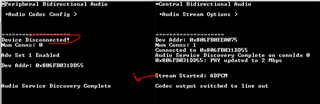

I am working on CC26x2 launchpad SDK v2.40, BLE audio transfer project. I used this example project to transfer the audio from peripheral to central but it disconnect as soon as audio streaming start.
When I am configuring at central side to start stream using ADCM or mSBC peripheral get disconnected.

    I have connected the headphone on LINE-IN at the peripheral side and another headphone at the central side and then doing first initialization to start stream but it get disconnected immediately.

    Following are the test results:
    1. Confirmed CC3200AUDIOBOOT hardware by running audio_echo_test example on both hardware and it's working fine.
    2. Then I compile peripheral and central project and programmed on two different board.
    3. But I got similar connection error as issues reported in thread which link you shared me.
    4. I tested by changing different PHY configuration at the central side but most of having similar error.
    5. I changed the configuration of PHY to "PHY: 1M, Codec: mSBC,  Fs: 16khz" and this doesn't throw error for 1 minutes after starting streaming, but I can't hear audio from "LINE OUT".
    I confirmed my network using BLE scanner and none of the another BLE device running nearby.
    Not sure why it is not working.
  • Now working. Issue was default peripheral selected to digital MIC.
