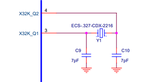

we using a CC2650 custom board. Can't connect with android, I trying to connect the device with nRF App(Android) it's showing Error 133(0x85): GATT ERROR. Same code working in CC2650 Launchpad.
what is wrong with the custom board.

You can review https://www.ti.com/lit/swra495 for details on the crystals on CC26xx.
You can refer to the User's Guide (https://www.ti.com/lit/swru393), especially in the section "Using 32-kHz Crystal-Less Mode" (§6.6).
