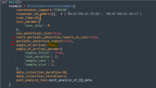

    • Have you verified if you manage to enable CTE sampling using the RTLS UI? (visual demo)
    • If you are using the python script, have you verified you have enable CTE reception?
      • Yes, I haved already enabled these function you mentioned.
      • Rtls coordinator can scan, synchronize and perform the IQ sampling with rtls responder.
      • So I think the setting is correct.

    So I used the python script rather than RTLS UI.
    And I found that is just can perform the IQ sampling with TI board but not with other boards.
    Do you have any idea or I just can use it with another TI board ?
