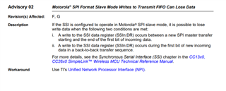

We gone through Errata sheet swrz085a and in this doc it is mentioned that
Advisory 02 Motorola® SPI Format Slave Mode Writes to Transmit FIFO Can Lose Data
Is our issue is related to this Advisory only ?
We wanted to open workaround document but not able to open it. Can you please share this workaround doc.

  • Hi Bhavin,
    The text of the errarata is located in the document, copied below for convenience.
    I think it's unlikely this is the issue you're seeing, but you can check by monitoring the SPI lines with a logic analyzer. Then you can see if the connection disconnected event is being sent at all. Once we figure out whether the BLE-A device is sending the host-microcontroller the disconnected event, then we will know what device the problematic behavior is occurring on (Host-micro or BLE-A)
    Nate
