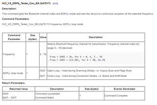

  • Hi Vishnuprasad,
    I think you need the "HCI_VS_DRPb_Tester_Con_RX (0xFD17)" command:
    Unfortunately, this command was not included in the BTVS.c (VS API's). However, you can still run this command via the "HCI_Send_Raw_Command" API. You can find some examples of how this API is called in the BTVS.c file.

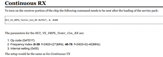

    I'm not sure about the data pattern PA9, but you can put the CC2564C device in continuous RX or TX mode by adding HCI commands to the BTS. For example, in the CC256X Testing Guide:
    Continuous TX
    Continuous RX
    Can you try using these HCI commands? You may want to check out HCITester to edit the BTS.
